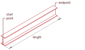

Creating Structural Members
You create a structural member in AutoCAD Architecture 2025 toolset by extruding a structural shape along a path. The style that you use to create the structural member provides the shape. The shape, similar to a profile, is a 2-dimensional cross-section of a structural member. You define the extrusion path (axis) of the member when you specify start and endpoints for the member or when you convert linework to a member.
Creating a structural member

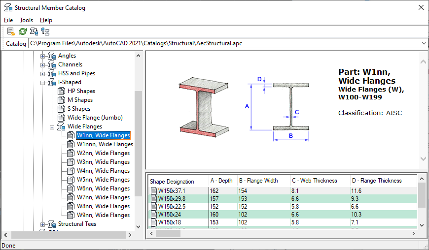

Creating Styles with the Structural Member Catalog and Structural Member Style Wizard
To create styles for most standard beams, braces, and columns, you can use the Structural Member Catalog included in AutoCAD Architecture 2025 toolset. The catalog contains specifications for industry-standard concrete, steel, and timber structural shapes organized in a File Explorer-like tree view. You can browse the catalog, select a shape, and create a style.
If you know the type, shape, and shape dimensions of the member that you want to create, you can quickly enter the information in the Structural Member Style wizard to create a style. You can create a structural member shape within a style that is based on any of the member shapes in the catalog.
