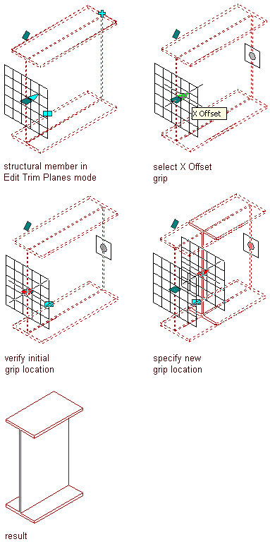

  • Define the position of the trim plane relative to the start or end of the extruded axis of the member.
  • Offset the trim plane in the X direction to move the origin of the trim plane along the extruded axis of the member.
Offsetting a trim plane in the X direction

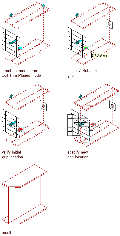

  • Rotate the trim plane around its Y axis to specify a cutting plane angle.
    Rotating a trim plane about its Y axis
  • Rotate the trim plane around its Z axis to specify a cutting plane angle.
    Rotating a trim plane about its Z axis
