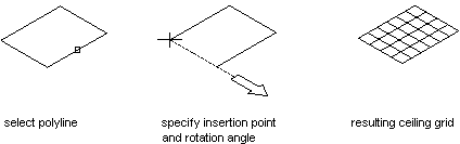

Use this procedure to create a ceiling grid within a closed polyline or a space object. If the ceiling grid is within a space, the grid is created at the ceiling height of the space.
  1. Open the tool palette that contains the ceiling grid tool you want to use, and select the tool.
    (You may have to scroll to display the desired tool.)
  2. On the Properties palette, expand Basic, and expand General.
  3. Click the setting for Boundary.
  4. Click Select object, and then select an existing space or a closed polyline in the drawing.
  5. Specify an insertion point in the drawing.
    Note: The insertion point of the ceiling grid is the lower-left corner of the ceiling grid if the rotation is set to 0 degrees.
  6. Specify the overall size of the grid by dragging the cursor to the desired size and clicking once.
    Drag the cursor along the X axis to specify the number of bays along the X direction, and drag the cursor along the Y axis to specify the number of bays along the Y direction.
  7. Specify the rotation angle of the grid, and press ENTER.
    The grid is displayed only within the space or closed polyline.
Creating a ceiling grid from a polyline
