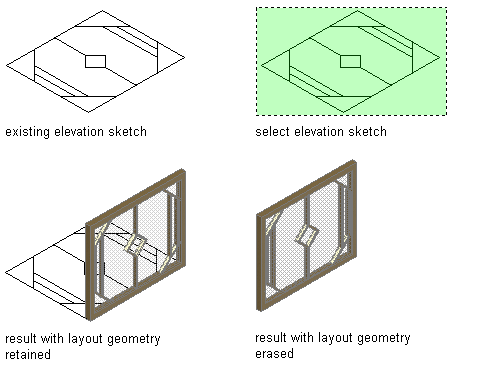

  1. Use lines, arcs, and circles to draw a grid in the world coordinate system (WCS).
  2. Open the tool palette that contains the door/window assembly tool you want to use.
    Note: You may have to scroll to display the desired tool.
  3. Right-click a door/window assembly tool, and click Apply Properties to Elevation Sketch.
  4. Select the linework of your sketch, and press Enter.

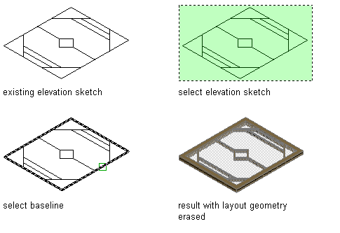

  5. You have the option of either selecting a baseline for the door/window assembly or accepting the default baseline. Select one of the grid lines as the baseline for the door/window assembly.
    Or press Enter to use the line along the X axis as the default baseline.
    Tip: If you draw your linework in the XY plane (in Plan view) and accept the default baseline, the resulting door/window assembly is displayed from the Z direction.
  6. To erase the lines, enter y (Yes). To have the lines remain after the door/window assembly is created, enter n (No).
