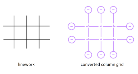

You can create a custom column grid based on linework that is non-orthogonal in shape. For example, if you have a drawing of an irregular plot, you can create a custom column grid based on linework. Since the resulting grid has a custom shape, the ability to edit it after creation is limited to general properties and location properties. You cannot change the number or spacing of grid lines, nor can you automatically label them.
Custom grid from linework
  1. Create the linework you want to convert to a column grid.
