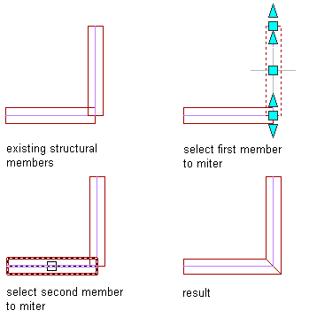

Mitering two structural members with coincident endpoints
  1. Select one of the structural member(s) you want to miter.
  2. Click Structural Member tabModify panelMiter.
  3. Select the other structural member.
