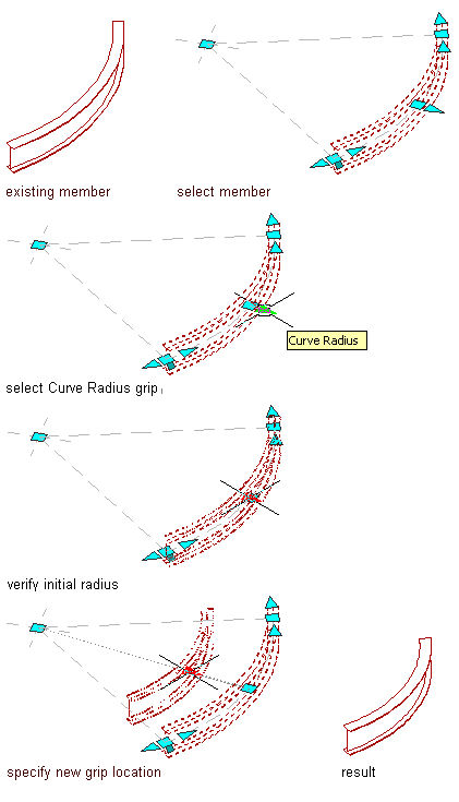

Use this procedure to change the radius of a curved structural member. You can also change the structural member radius on the Properties palette.
  1. Select the structural member.
  2. Select a Curve Radius grip, move the grip until the radius value you want is displayed, and click once.
    Change the curve radius of a curved beam structural member with grips
