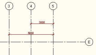

To Dimension Individual Grid Bays
You can dimension individual grid bays, or a range of multiple grid bays on an enhanced custom column grid.
Note: This command inserts a rotated AutoCAD dimension with the Annotative dimension style.
  1. Select the enhanced custom column grid.
  2. Click Column Grid tab Custom Column Grid panel Dimension Bay.
  3. Select the grid line from which to start the dimension.
  4. Select the grid line on which to end the dimension, and place the dimension as desired.
