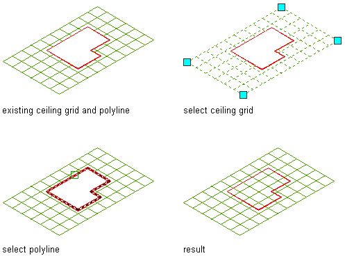

Use this procedure to remove holes you have created in ceiling grids.
  1. Select the grid from which you want to remove holes.
  2. Click Ceiling Grid tabClipping panelRemove Hole.
  3. Select the closed polyline of the hole.
The hole is removed from the ceiling grid. The polyline, however, remains in the drawing. If necessary, you can delete it.
Removing a hole from a ceiling grid
