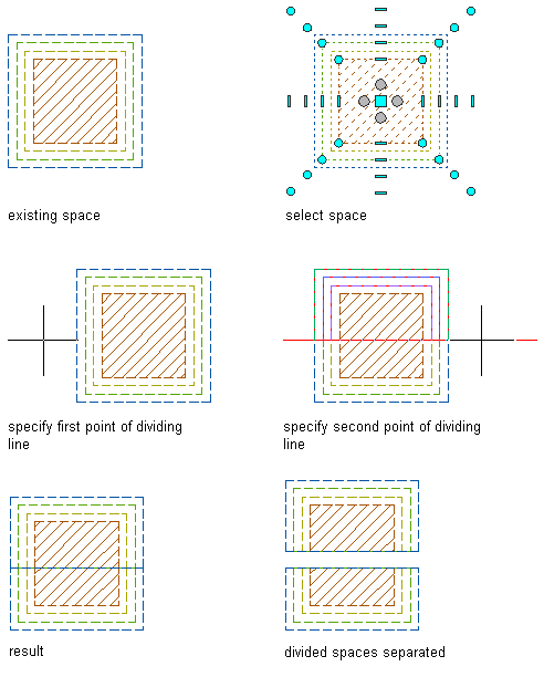

Use this procedure to divide an extruded 3D space into smaller spaces by using a divide line. The space is split at the line.
Note: This procedure is valid for non-associative spaces only.
All properties - like for example property data, calculation modifiers, or boundary offset types - will be applied to both resulting spaces.
Attention: If you are dividing a space with manual boundary offsets, verify that the all boundaries are activated. Boundaries that are not activated are not divided.
  1. Select a space to divide, right-click, and click AEC Modify Tools Divide .
  2. Specify the divide line start point.
  3. Specify the divide line endpoint.
    Depending on the boundary offset type, the divide line will create different results for the net, usable, and gross, boundaries.
