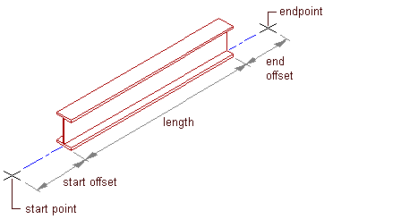

- Specify offsets:
If you want to… Then… offset the beam on its extruded axis at the start point of the beam enter a value for Start offset. A positive value shortens the beam on its axis, while a negative value lengthens the beam on its axis. offset the beam on its extruded axis at the endpoint of the beam enter a value for End offset. A positive value lengthens the beam on its axis, while a negative value shortens the beam on its axis. - Enter a value for Roll.

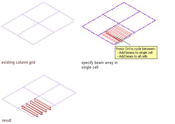

- Select a Layout type to specify how a beam is positioned in relation to a highlighted edge of a column grid, slab, roof slab, or wall:

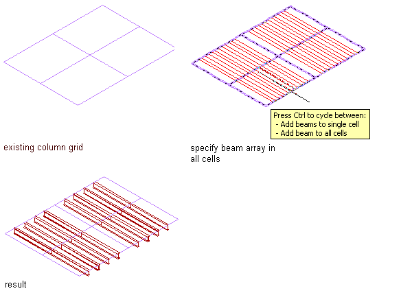

If you want to position the beam… Then… along the highlighted edge of the object select Edge for Layout type. within the boundaries of the object (from one edge to an opposite edge or edges) select Fill for Layout type. - If Layout type is Fill, and you want to array multiple beams between 2 existing beams or within a column grid, slab, roof slab, or wall, expand Layout and select Yes for Array.
- Specify the layout method for the array:
If you want to array beams… Then… so that they create a specific number of equal-sized bays select Space evenly for Layout method, and enter a value for Number of bays. at a specific distance from each other select Repeat for Layout method, and enter a value for Bay size. Tip: After specifying the desired settings, you can move or hide the Properties palette to expose more of the drawing area. - If you want to offset the new beams from the elevation of the current level, double-click the Elevation value on the application status bar at the bottom of the workspace, enter an elevation value (or specify a point on an existing object in the drawing area), click OK, and then click the Z-snap button to the right of the Elevation value.

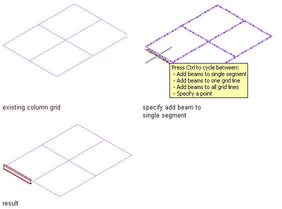

Adding a beam to a single segment

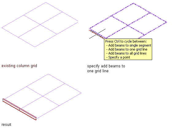

Adding beams to one grid line

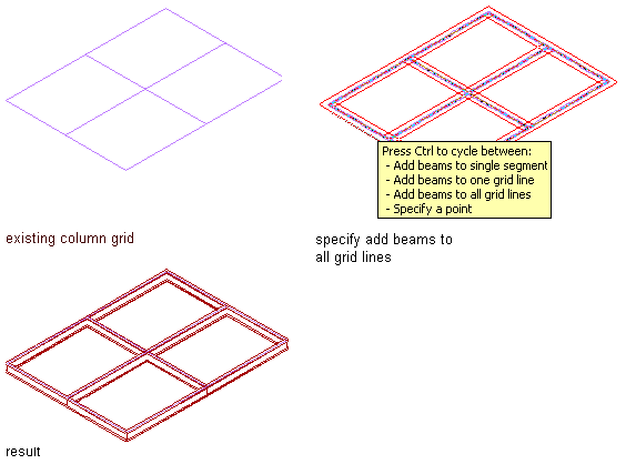

Adding beams to all grid lines

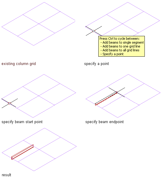

Adding a beam to a specified point
Adding a beam array to a single cell
Adding a beam array to all cells
