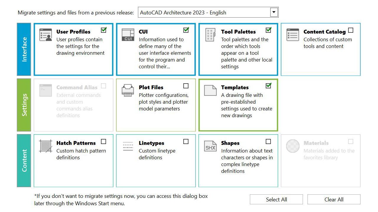

Migration: Custom path in Support File Search can now be migrated successfully from older releases.
