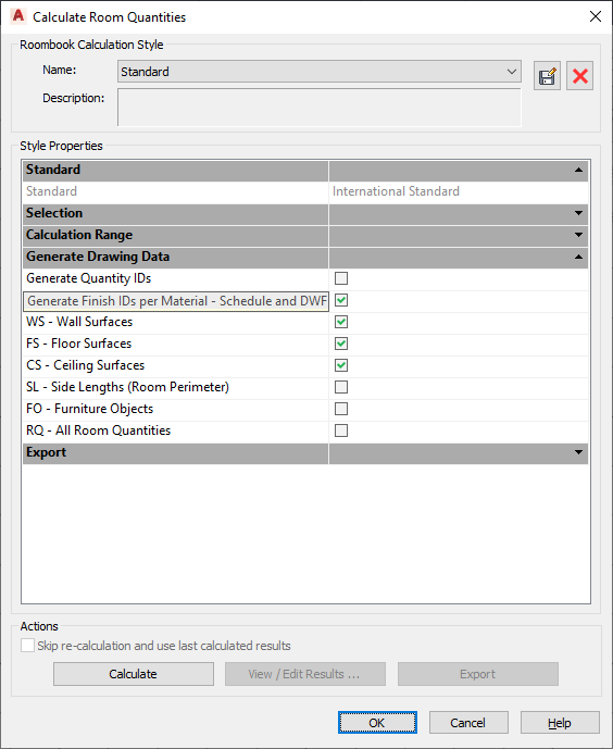

  1. Click Vision Tools tab Roombook panel Calculate Room Quantities.
  2. In the Calculate Room Quantities dialog box, under Style Properties, Generate Drawing Data list, select Generate Finish IDs per Material.
    Note: The Generate Finish IDs per Material option must be enabled to export the Roombook data to DWF files for Autodesk Quantity Takeoff.
  3. Select the room quantities and click Calculate.
  4. Click OK.
  5. In the AutoCAD, click Application menu Export DWF.
