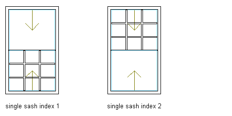

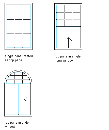

- If the window style contains multiple sash, specify whether you want muntins applied to the Top, All, or a Single sash component in the window:
If you want to attach muntins to… Then… the top sash only under Window Pane, select Top. Top also applies to single sash. all sash under Window Pane, select Other, and select All. an individual sash component under Window Pane, select Other. Select Single, and specify the index number for window sash. Sash is indexed counterclockwise, starting from the lower left corner.
Specifying rectangular muntins for top sash
Specifying rectangular muntins for an individual sash component

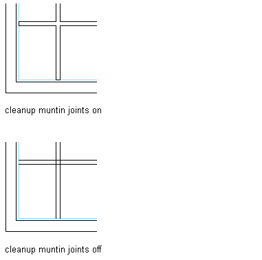

- Clean up the muntin intersections:
If you want to convert… Then… the muntin intersections to corners under Muntin, select Clean Up Joints. all the muntins to one body with the joints cleaned up under Muntin, select Convert to Body.
Specifying rectangular muntin cleanup joints

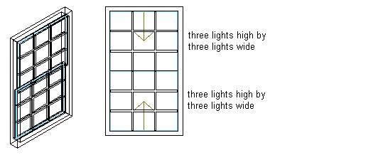

- Under Lights, select Rectangular for Pattern.
- Enter a value for Lights High to specify the number of light rows in the vertical direction.
- Enter a value for Lights Wide to specify the number of light columns in the horizontal direction.
