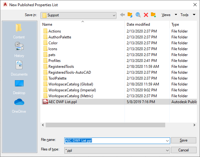

  2. In the AEC DWF Publishing Options dialog box, click New.
  3. Browse for the folder in which you want to save the new PPL file, and enter a name for the new PPL file.
  4. Click Save.
