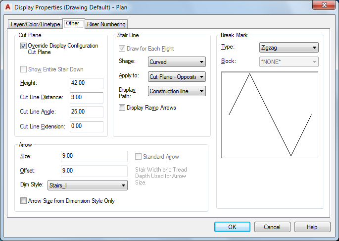

  11. You can also access and modify these same cut plane settings through the stair’s context menu, as follows:
  1. Select the stair you want to change, right-click, and click Edit Object Display.
  2. Click the Display Properties tab.
  3. Select the display representation where you want the changes to appear, and select Object Override.
    The display representation in bold is the current display representation.
  4. If necessary, click .
  5. Click the Other tab.
  6. In the Cut Plane panel, change the settings as needed.
  7. Click OK twice.
