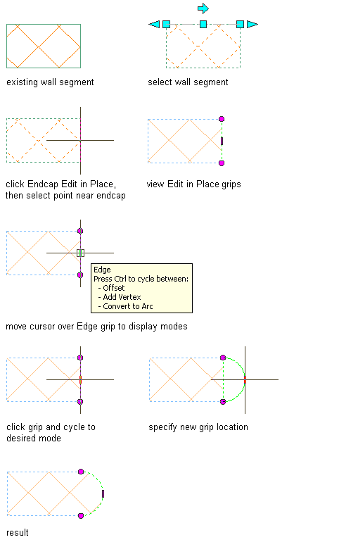

  1. Select the wall segment with the wall endcap to modify.
  2. Click Wall tabEndcap panelEndcap Edit In Place.
  3. Specify a point at the wall endcap.
  4. Move your cursor over the Edge grip to display the available modes.
  5. Select the Edge grip, and then press Ctrl twice.
  6. Specify a new location for the Edge grip.
  7. Save or discard your changes:
    If you want to... Then...
    Save any changes you made during the edit-in-place session as a new style click Edit In Place tabEdits panelSave As.
    Discard any changes you made during the edit-in-place session click Edit In Place tabEdits panelCancel.
    Save any changes you made during the edit-in-place session click Edit In Place tabEdits panelFinish.
    In the following example, a wall endcap edge is converted to an arc with an Edge grip.
