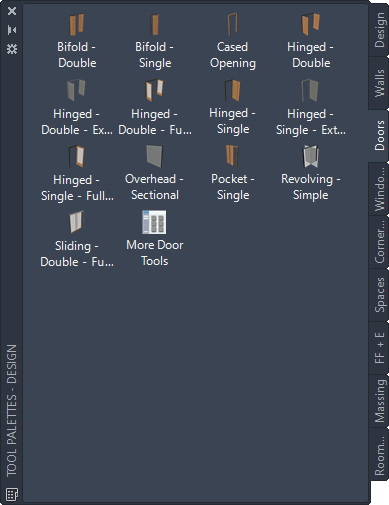

In a standard US installation of AutoCAD Architecture 2026 toolset, you can find door tools in the following locations:
- Tool Palettes: Design Tool Palettes group
Design tab (standard door tool) - Tool Palettes: Design Tool Palettes group
Doors tab - Content Browser
Stock Tool Catalog
Architectural Object Tools (standard door tool) - Content Browser
Sample Palette Catalog
Design
Doors - Content Browser
Design Tool Catalog
Doors and Windows
Doors
Predefined door tools
