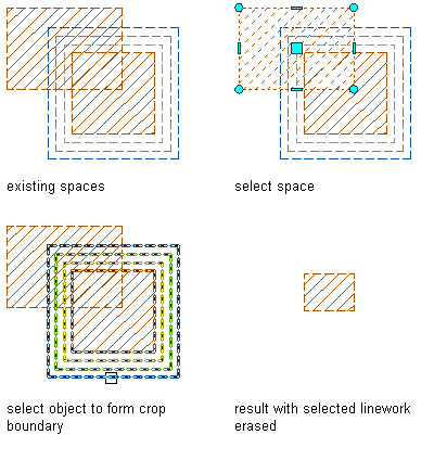

Intersecting spaces with all boundaries activated
If a manual space boundary on the first space is not activated (displaying its grips), it is not included in the intersecting operation. This will effect the existing boundary on the first space to remain as it is, and the corresponding boundary on the second space to be deleted. This can result in irregular space boundaries. To avoid this, make sure that all relevant boundaries on the first space are activated.
Intersecting spaces with only base boundary activated
The display properties of the boundaries of the first selected space are applied to the resulting intersection boundary. For example, if the net boundary of space 1 is red with a lineweight of 0.18 mm, the net boundary of the resulting space will be red with a lineweight of 0.18 mm.

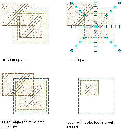

Intersecting Spaces with Style-Defined Boundary Offsets
If you intersect spaces with style-defined boundary offsets, the base boundaries of both spaces are intersected with each other, and the boundary offsets defined in the style of the first space are applied to the resulting intersection space.

  1. Create 2 overlapping spaces.
  2. Select the first overlapping space, right-click, and click AEC Modify Tools Crop .
  3. Select the second overlapping space.
  4. Enter y (Yes) to erase the original spaces, or n (No) to leave the spaces in the drawing.
