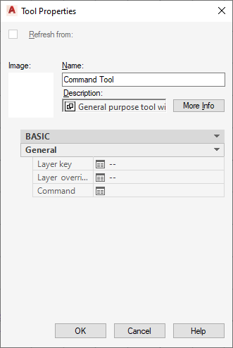

  4. On the tool palette, select the command tool, right-click, and click Properties.
    Command tool properties
  5. Change the following tool properties as necessary:
    Property Description
    Name Lets you replace the generic command tool name with a name that describes the function of the tool.
    Description Lets you add a more detailed description to the command tool.
    Layer key Specifies the layer key to define the layer on which objects created with this command will be inserted.
    Layer overrides Defines overrides for the selected layer key.
    Command Specifies the command to be executed by the tool. The following command types are valid within the Command Tool:
    • AutoCAD and AutoCAD Architecture 2026 toolset commands
    • AutoLISP routines
    • VBA macros and applications
    • Scripts
    Image By default, the command tool has no associated image. To add an image that illustrates the function of the tool, right-click in the empty image area, and select an image.
