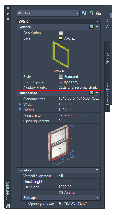

  1. Select the windows you want to change, and double-click one of them.
  2. On the Properties palette, expand Basic, and expand Dimensions.

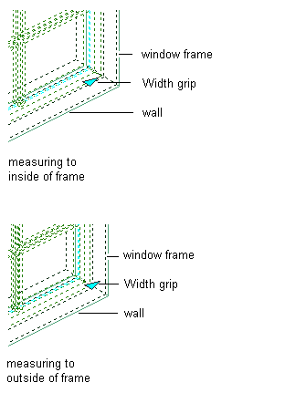

  3. Specify the location to which window width and height is measured:
    If you want to size the windows… Then…
    to the inside frame select Inside of frame for Measure to.
    to the outside frame select Outside of frame for Measure to.
    to the center frame (in corner windows only) select Center of Frame for Measure to.
    Specifying window frame measurement
  4. Specify the width of a window. For corner window, width is a sum of width 1 and width 2.
    If you want to specify... Then…
    the width of a corner window pane anchored to a wall enter a value for Width 1 or use the pick tool to pick two points to specify a distance.
    the width of a corner window pane that is not anchored to a wall enter a value for Width 2 or use the pick tool to pick two points to specify a distance.
    Note: When you add a corner window, the first wall you specify is anchored to the wall. When you flip the wall, the second wall is anchored.
  5. To specify the height of the window, enter a value.
