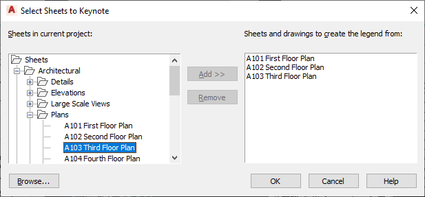

    include all keynotes from other sheets right-click, and click Sheets to display the Select Sheets for Keynote Legend dialog box. The left pane lists sheets in the current project. Select sheets as desired and move them to the right pane by clicking Add. You can also click Browse to find and retrieve sheets from other projects or drawings that have not been saved as sheets. When the right pane shows all the drawings/sheets from which you want to include keynotes, click OK.
