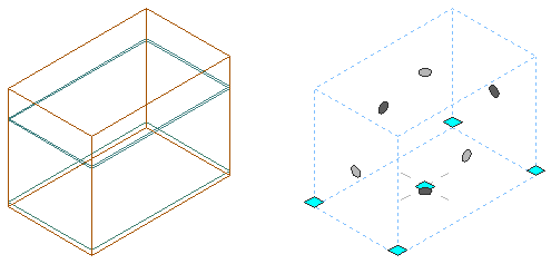

  1. Select the space where you want to split a surface.
    3D space (left) in in-place editing mode (right)
  2. Click Space tabModify panelEdit In Place.

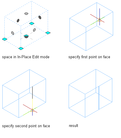

  3. Click Edit In Place tabModify panelSplit Face.
  4. Select the start point of the splitting line.
  5. Select the endpoint of the splitting line.
  6. To save the changes to the space, click Edit in Place tabEdits panelFinish.
