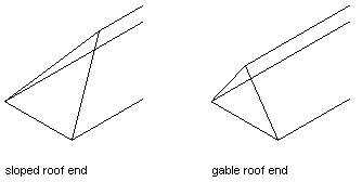

Use this procedure to add a gable roof that has the properties specified in the roof tool that you select. You can create a single sloped roof and set each edge to gable as needed. You can specify a slope for the gable ends to create a hip.
Viewing a gable roof end
Note: You can create a gable on an existing roof by gripping any ridge line point and stretching it past the roof edge.
