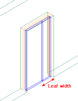

Leaf width Uneven, Uneven-Dhung, and Uneven Opposing door types only Determines the width of the door panel in an uneven door type
Illustration
Enter a value for Leaf width, or click to pick points on the screen to specify the leaf.

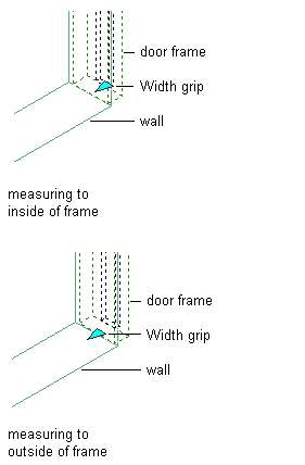

Measure to   Specifies whether the width and height of the door is measured to the inside of the door frame or the outside. When a door is measured to the outside of the frame it is smaller by the amount that is deducted for the frame.
Illustration
Click the drop-down list and select Inside of Frame or Outside of Frame.

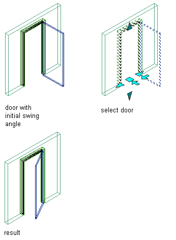

Swing Angle   Lets you determine at which opening angle the door will be displayed.
Swing angle and display properties
The swing angle can also be determined in the display properties of the door style. The settings in the style override properties setting.
Illustration
Enter a value.
