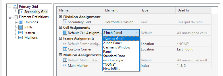

(new cell assignment). A new cell assignment is displayed in the list of cell assignments.
- Right-click the default name, click Rename, and enter a descriptive name for the assignment.
- Select Nested Grid in the Element column.

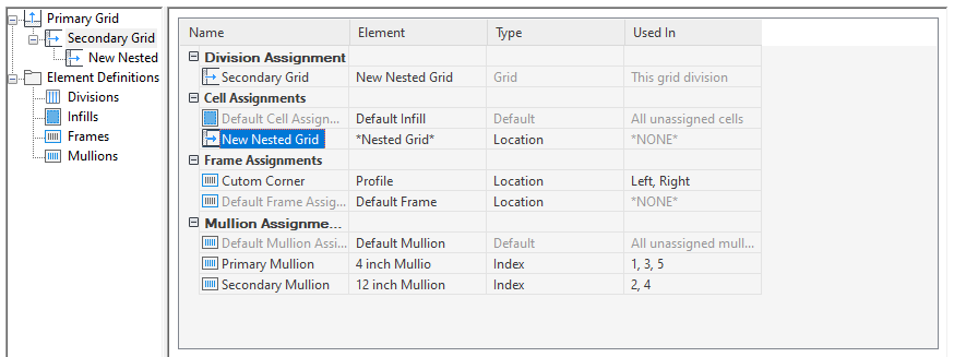

A new grid is added to the list of grids in the left pane of the dialog box. If you are editing the primary grid, the new grid is added at the secondary level. If you are editing a grid at the secondary level, the additional grid is placed at the tertiary level, and so on.
Creating a nested grid
New nested grid in tree
Note: To rename a grid, select it in the right pane, right-click, and click Rename, and enter a new name. - Specify the cells to contain this nested grid.
- Click OK.
