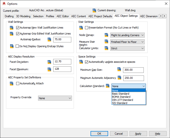

  6. Add a call to the AecSpaceOffsetStandard.SetName(string name) method.
    The AecSpaceOffsetStandard.SetName() method is implemented in the base class and cannot be overridden. It needs to be called to register a name for the standard in the constructor of the class. This is the name that will show up in the list of available area calculation standards in AutoCAD Architecture 2026 toolset.
  7. Add the call to the SetName() method in the constructor of your class.
