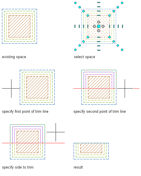

Attention: If you are trimming a space with manual boundary offsets, verify that the all boundaries are activated. Boundaries that are not activated are not trimmed.
Trimming spaces with different boundary offset types

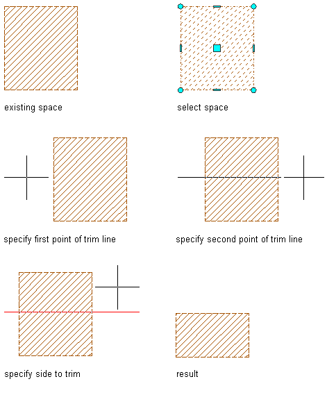

  1. Select the space to be trimmed, right-click, and click AEC Modify Tools Trim .
  2. Specify a start point for the trim line.
  3. Specify an endpoint for the trim line.
  4. Select the side of the space to be trimmed.
