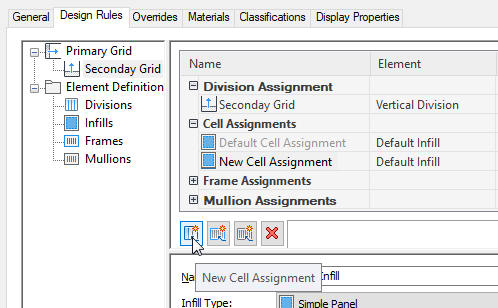

Use this procedure to fill a curtain wall cell with a simple panel. Simple panels are generally used to represent basic cladding materials in the curtain wall, such as a stone wall panel or a concrete panel.
  1. Click Manage tab Style & Display panel Style Manager .
  2. Expand Architectural Objects, and expand Curtain Wall Styles.
  3. Select a curtain wall style.
  4. Click the Design Rules tab.
  5. In the left pane, select the grid in which you want to put a simple panel infill.
  6. Click New Cell Assignment.
    A new cell assignment is displayed in the list of cell assignments.
  7. Select the cell assignment in the top right pane, right-click and click Rename, and then enter a descriptive name.
  8. Under Element, select an infill that defines a simple panel.
    If you do not have a simple panel infill defined, then select New Infill and define one.
  9. Specify the cells to contain this simple panel.
  10. Click OK.
