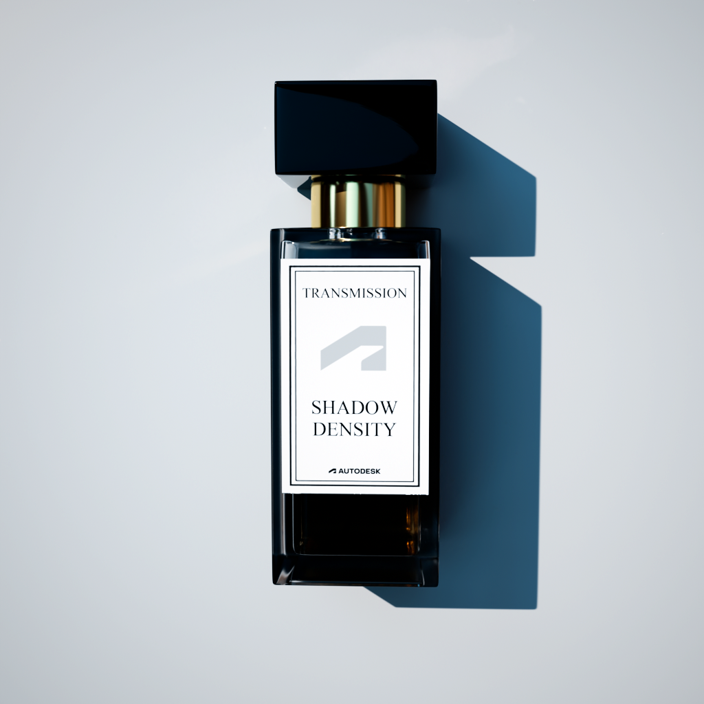

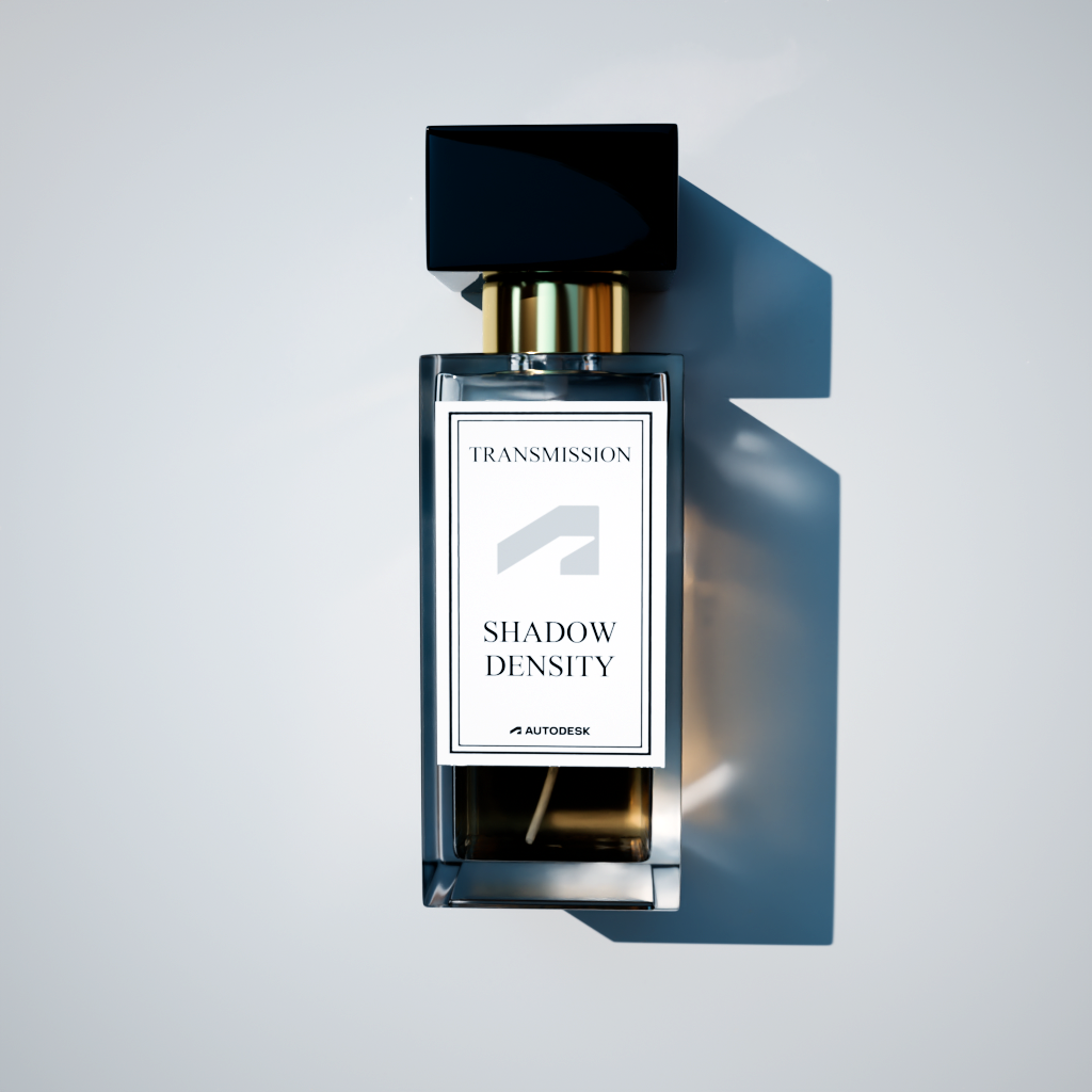

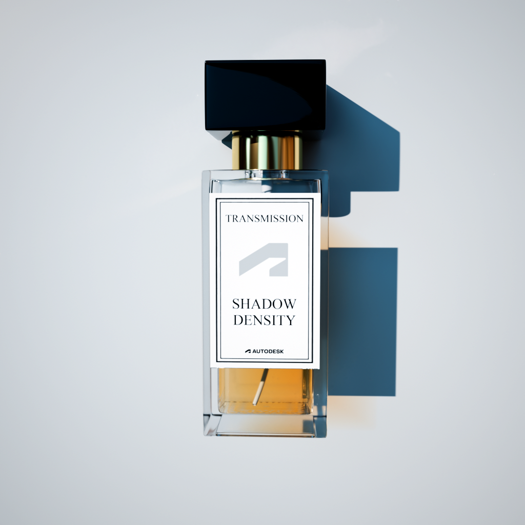

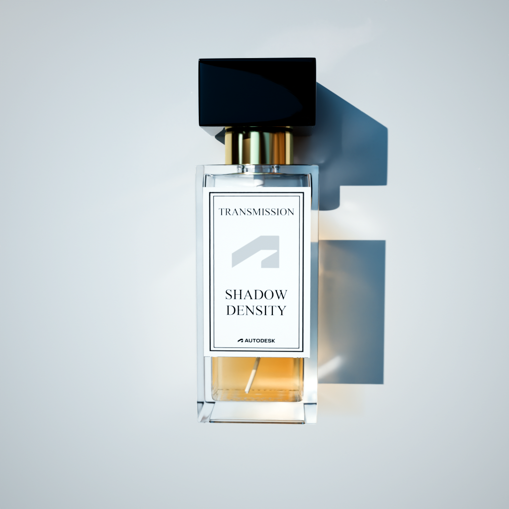

  • Improved, more realistic shadows for glass objects: Transparent objects like clear glass now cast shadows. The look of the shadow is controlled by the new transmission_shadow_density parameter on the openpbr_surface and the standard_surface shaders. (ARNOLD-6881, ARNOLD-15863, ARNOLD-15828)
0 0.5 0.9 1
transmission shadow density = 0 transmission shadow density = 1
