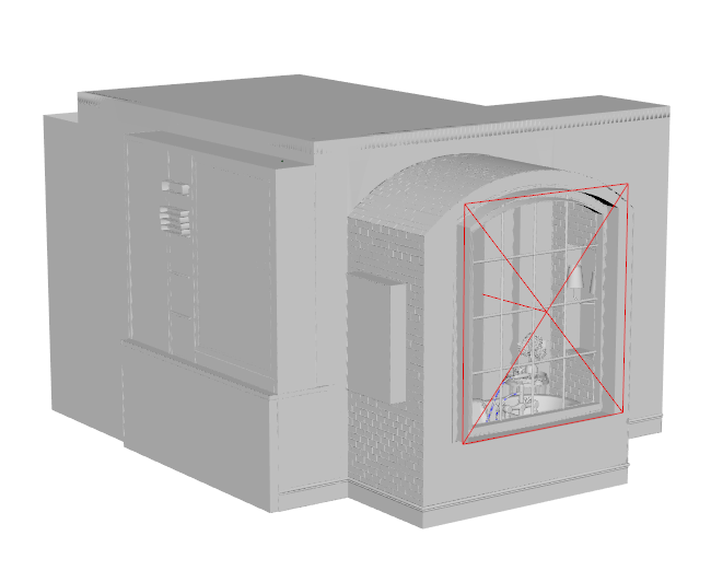

The light portal should be oriented so that it is pointing in through the window as indicated below:
Light portal pointing inwards, outside window
