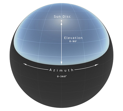

The Physical Sky uses a polar coordinate system. Elevation has an angle between 0 degrees to 180 degrees (sunrise to sunset). The sun is at the zenith at 90 degrees. The azimuth has an angle between 0 degrees to 360 degrees.

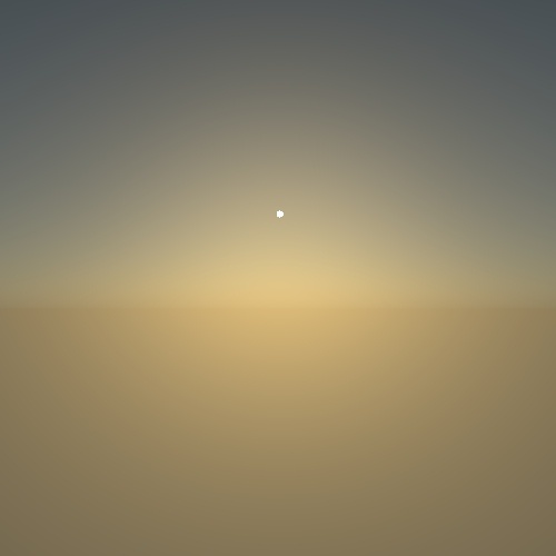

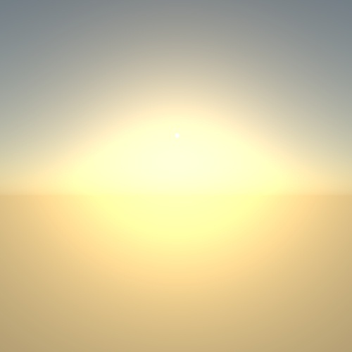

| 0 | 3 (default) | 5 |

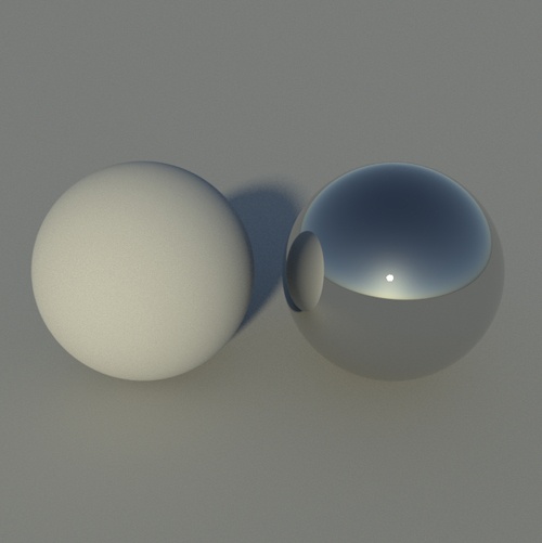

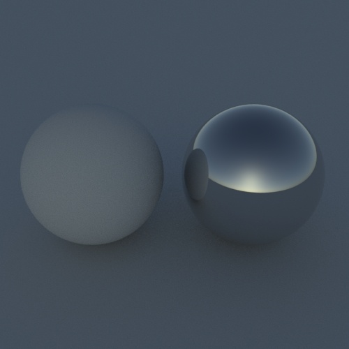

Ground Albedo
The amount of light reflected from the planet surface back into the atmosphere. This is an RGB value between 0 and 1, where 0 0 0 would correspond to a black ground, and 1 1 1 would be a white ground. Note, that this is a subtle effect (noticeable in the top corners of the images below).

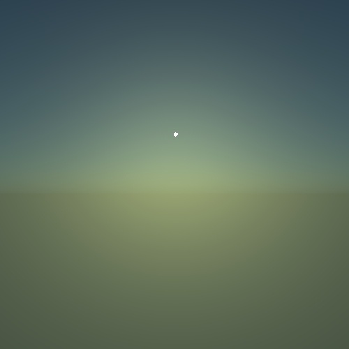

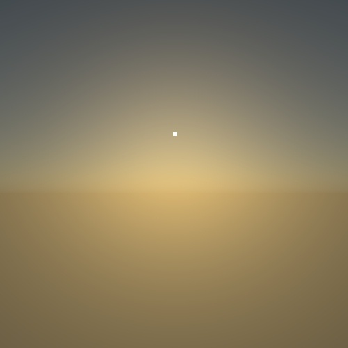

| 0.1 (defalt) | 1 |

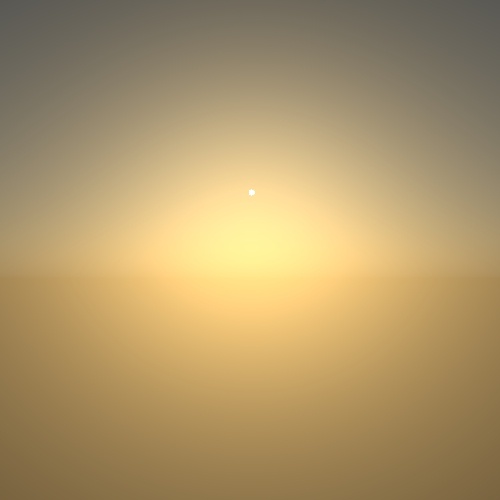

Elevation
The angle between the sun and the observable horizon. The range is between 0 and 180 (90 to 180 is a mirror reflection of 0 to 90).
| Sun Elevation: 0 to 48 degrees (azimuth 0 to 360 degrees) | Sun Elevation: 0 to 20 degrees |
Azimuth
The angle of the sun around the horizon. Measured from the north, increasing towards the east (0 to 360 degrees).

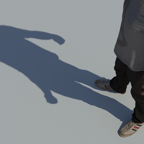

Sets the size of the visible solar disk. It is possible to change the size of the sun for 'artistic' reasons. However, 0.51 is the solid angle (degrees) of the sun, as seen from the earth. Increasing this value increases the area size of the sun and will, therefore, create softer shadows.
| 0.51 (default value) | 5 |

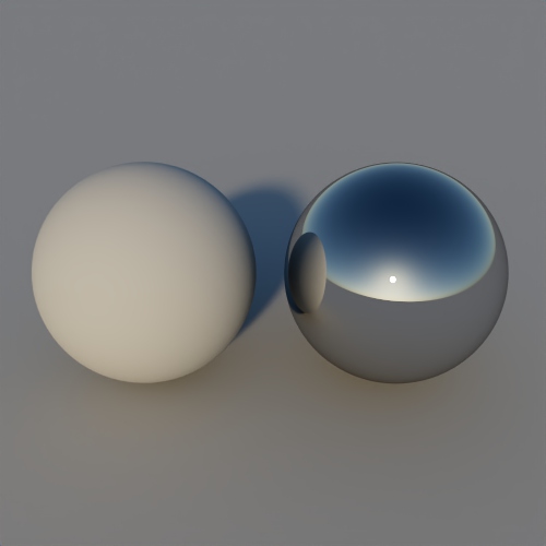

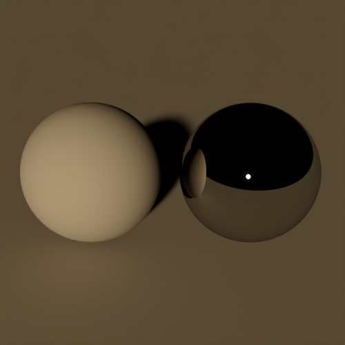

Enable Sun
The toggle switch that enables/disables the visibility of the sun.
| Enabled (default) | Disabled |

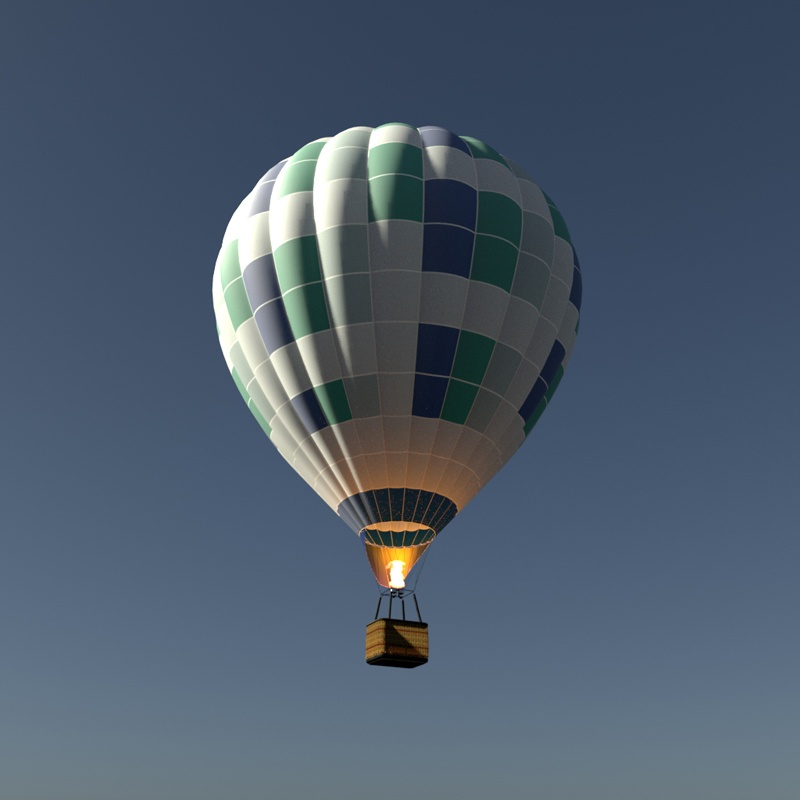

Two Physical Sky lights (one has Enable Sky disabled)

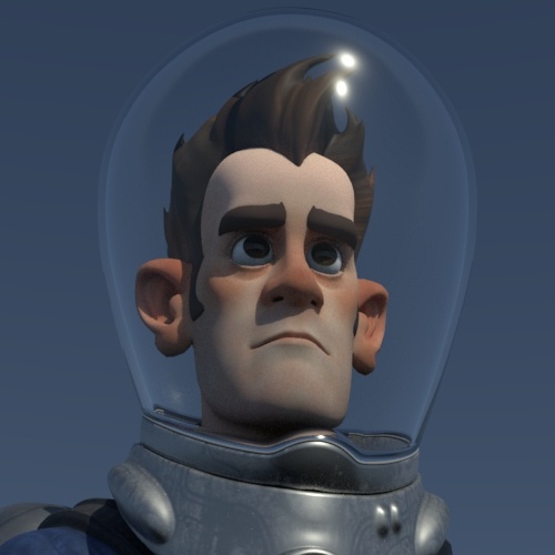

Fireflies

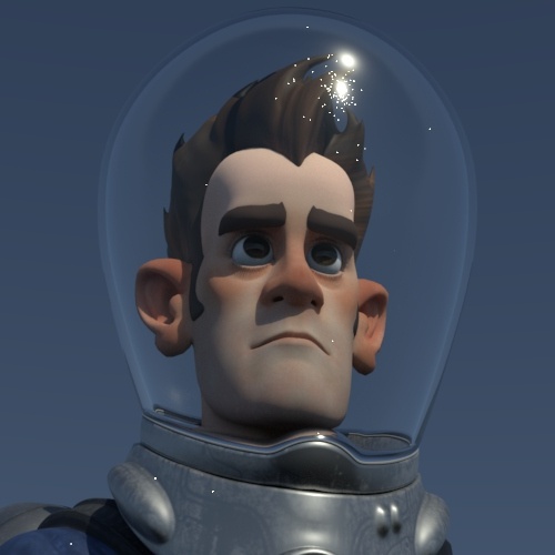

Fireflies can appear when rendering scenes with glass surfaces and the Physical Sky shader. They are caused by the bright sun disc from the Physical Sky that is connected to the Background. A workaround is to connect a different Physical Sky to the Background that has Enable Sun disabled.
| Fireflies caused by sun in Physical Sky | 'Sun Disc' disabled for Environment -> Physical Sky |

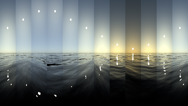

Further examples
