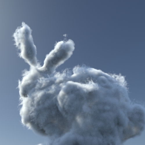

Polymesh rendered as a volume. Noise -> range -> standard_volume.displacement (step_size: 0.1, volume_padding: 0.05).
When the step_size is positive, it turns a polymesh into a volume, and its value is used as the base step for raymarching the volume.
The mesh should be closed and not have anything self-intersecting; otherwise, the volume may not render correctly.
You must add a step_size value and assign a standard_volume shader for the mesh to render as a volume.

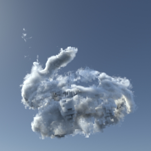

Sets the size for sampling inside the volume. It should be small enough to capture the smallest feature in the volume (aka the Nyquist limit). If the size is too large, aliasing, bias, or banding will appear. Smaller (and therefore more accurate) sizes will increase render times, while larger sizes will render more quickly.
Step_size basically controls the rate at which the volume shader gets called. The value indicates the average distance between adjacent volume shader samples along a given ray, in world space units. Generally, you will want this setting to be as large as possible before visibly noticeable artifacts occur, and in the case of voxelized volumes, no smaller than about half the size of your voxels (in world space). A low step_size will increase render times. For example, when the step_size is 0.1 and the volume is 10 units big in world space, there are approximately 100 primary samples and therefore the volume shader is called 100 times.
The step_size has a fixed size; therefore, the larger the container, the more steps will be taken and the longer it will take to render. Also, beware that if the step_size is too small, your render times will increase. If you cannot see the rendered volume, you may need to reduce the step_size value.

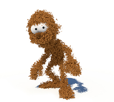

Enlarge the volume by padding. This is useful when displacing a volume with a noise, for example. Note that this slack applies not only to the bounding box but also to the voxels used for ray extents inside the bounding box. When velocity motion blur is enabled, some extra padding is computed based on the maximum value of the velocity field, and the maximum of the velocity padding and user padding is applied. When padding exceeds the bounding box's maximum dimension, the ray extents acceleration makes little sense and is disabled, so you should set the padding as tightly as possible.
For best performance, this should be set as low as possible, while still covering the maximum displacement amount.
