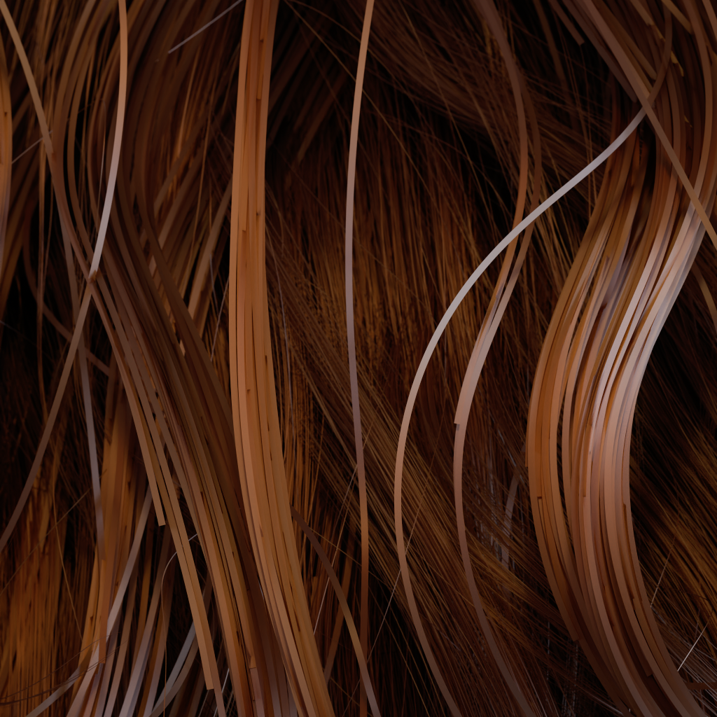

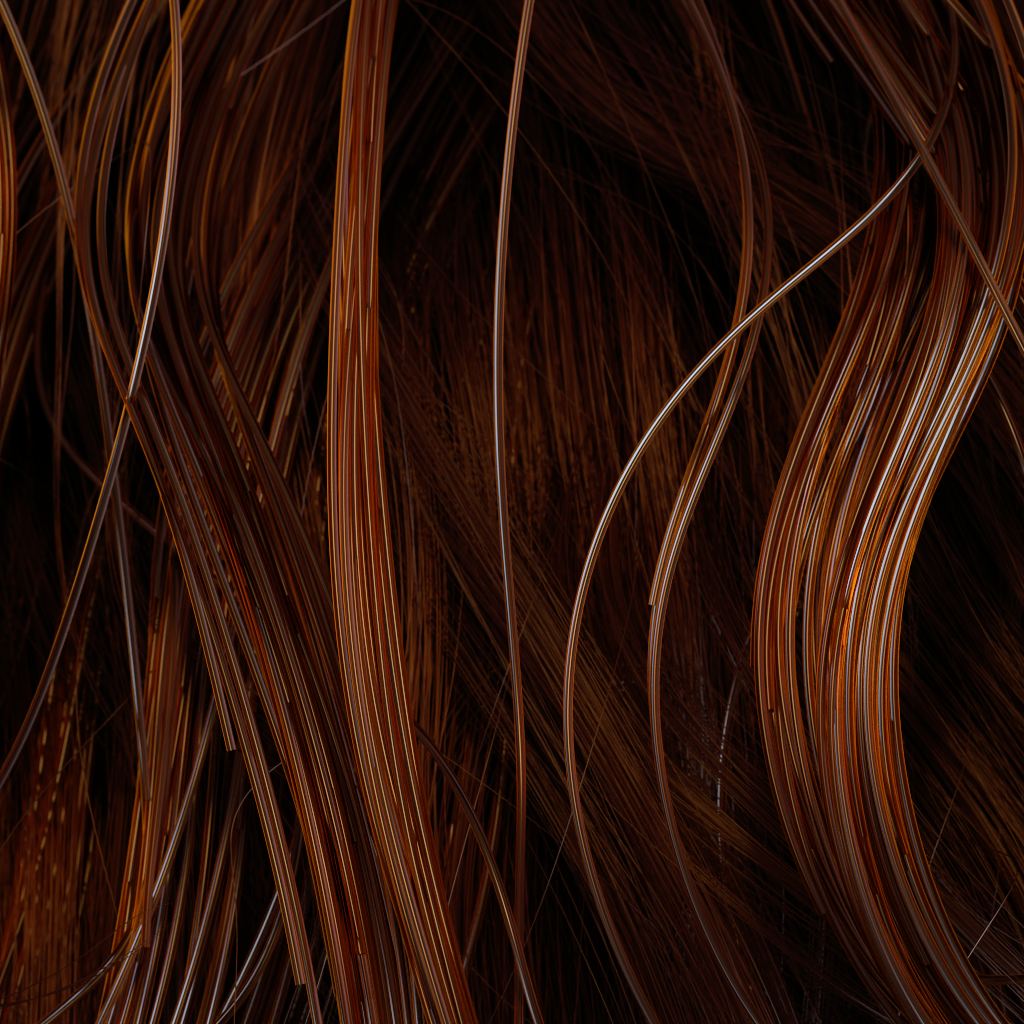

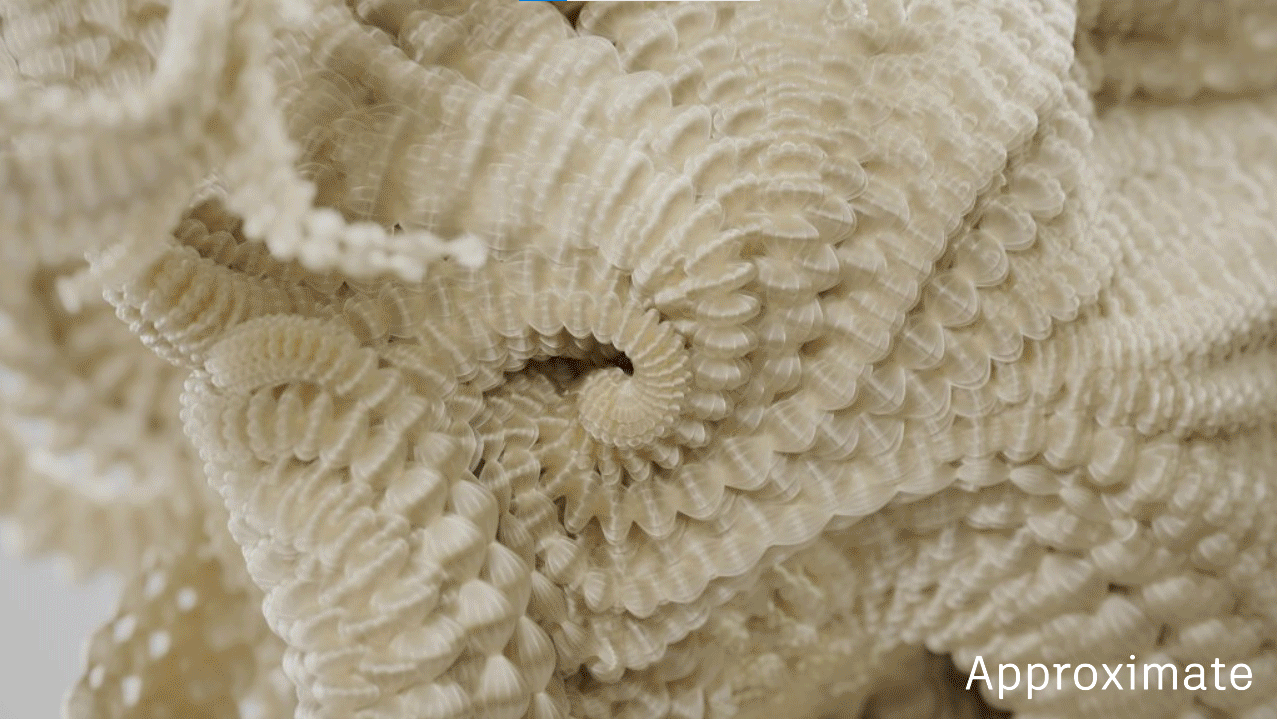

Approximate mode (default) reproduces the flat appearance of the underlying hair ribbons.
Accurate mode generates more accurate cylindrical shading, allowing hair ribbons to appear round in close-up views and producing more accurate lighting at a distance.
Adaptive mode probabilistically switches between the two modes based on the on-screen hair thickness.
| Approximate (default) | Accurate | Adaptive |
When viewed closely, we can see that the hair strands have a more realistic tube-like shape when the Scattering Mode is set to accurate.
