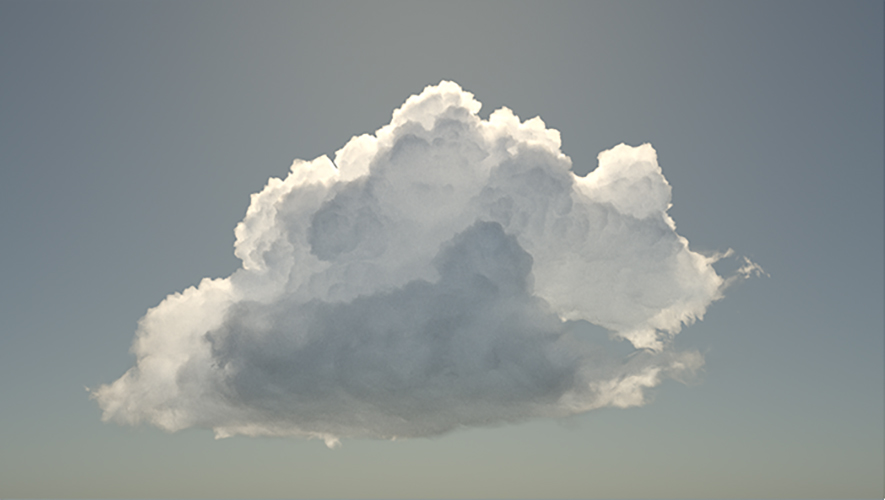

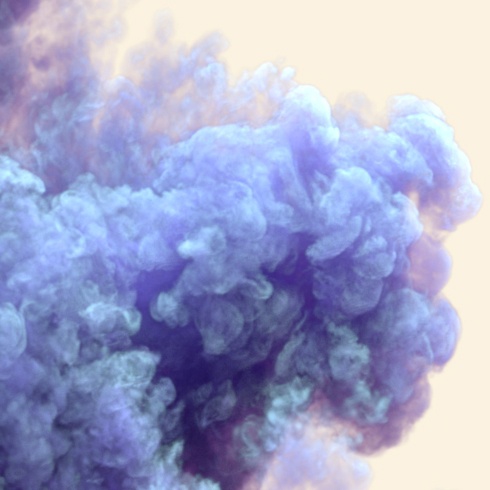

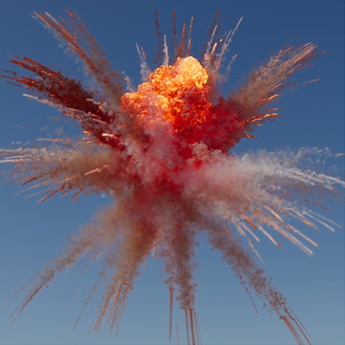

The Standard Volume is a physically-based volume shader. It provides independent control over volume density, scatter color and transparent color. Blackbody emission is used to render fire and explosions directly from physics simulations.
Each component can be controlled by a volume channel coming from the volume object, with other parameters acting as multipliers on the channel. Optionally the channel can be left empty, and a custom shader like Volume Sample RGB or a procedural texture may be connected instead, to manipulate each component with more control.
However, be warned that the evaluation of a shader network for volume rendering is much more expensive than for surface shading because the shader network is called many times per ray, once per ray march sample. So, in a production environment, it's best to use as few shaders as possible, ideally having just the Standard Volume shader doing all the work.

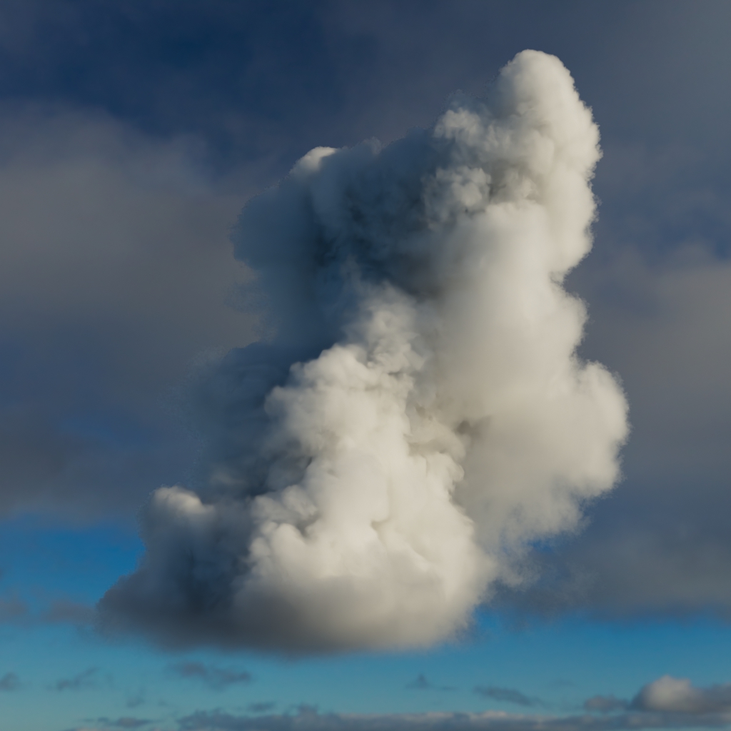

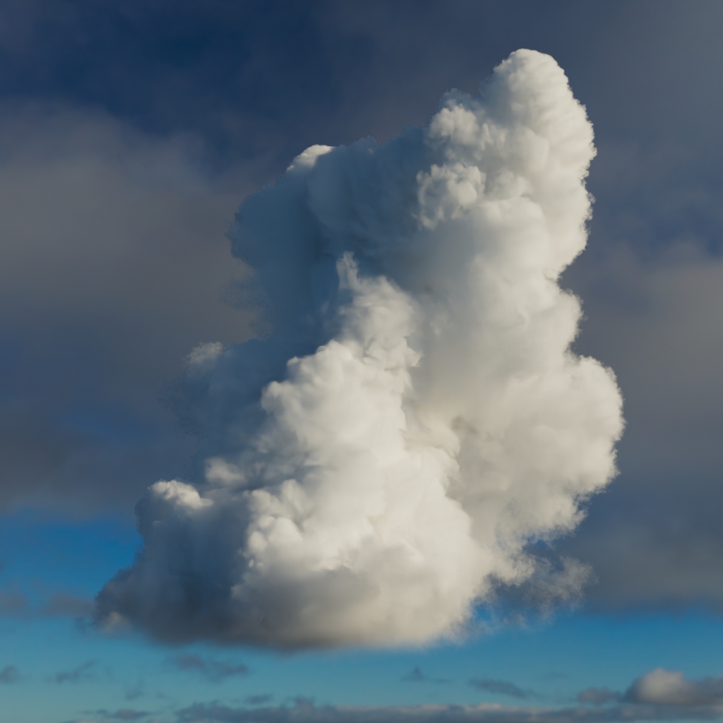

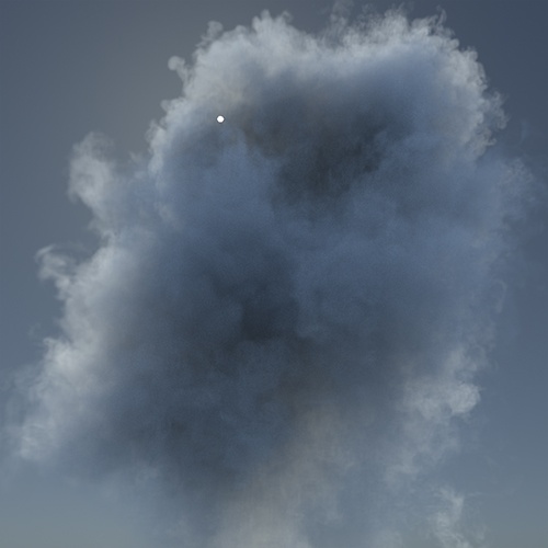

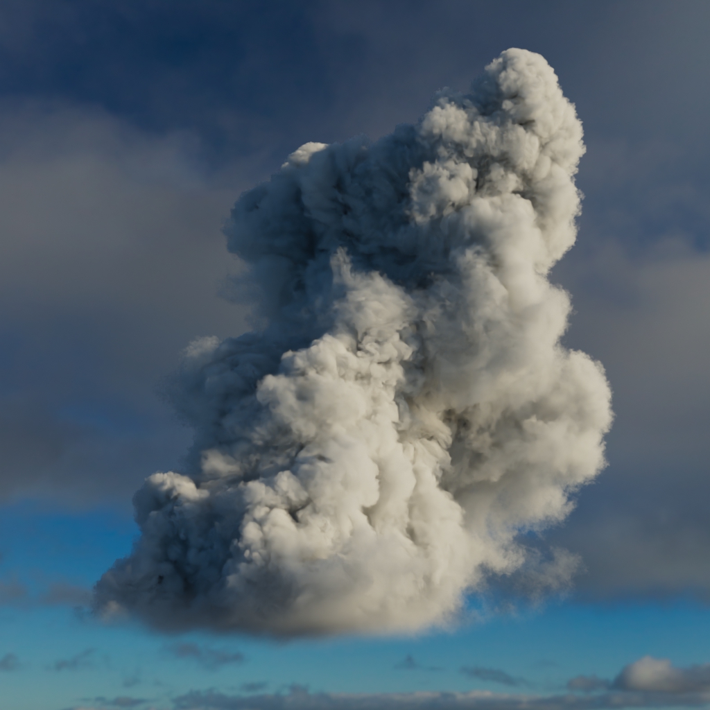

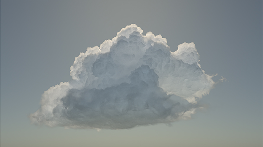

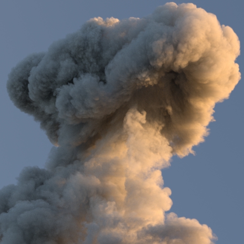

The images in the examples below use a volume ray depth of 8 (defaults to 0). This is useful when rendering volumes such as clouds for which multiple scattering has a large influence on their appearance.
It is recommended that volume shading networks are kept as lean as possible. This is important to render times in the volume context because it is evaluated so often.

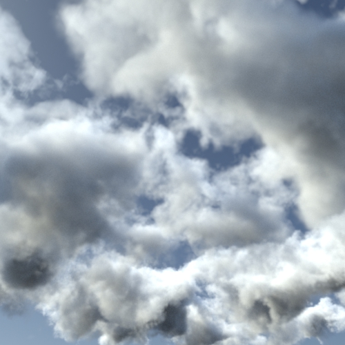

The Walt Disney Animation Studios Cloud Data Set is available here.

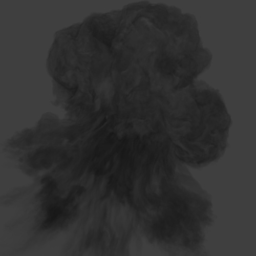

Density

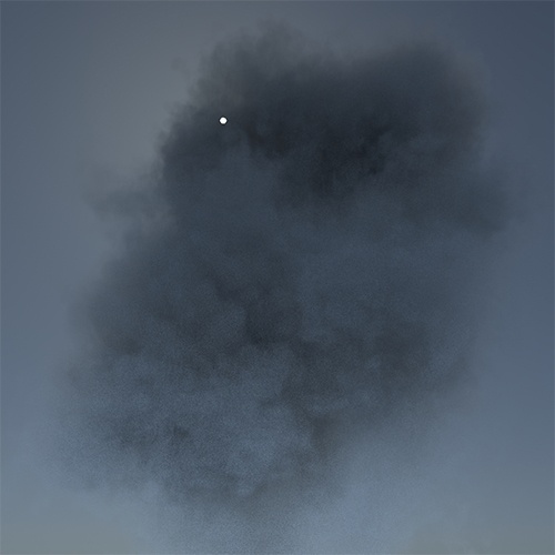

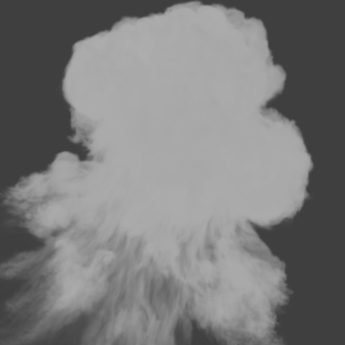

The density of the volume, with low density resulting in thin volumes and high density in thick volumes. It acts as a multiplier on the density channel, or if no density channel is specified, it may be used to connect a shader like a volume sample or a procedural texture.
| 0.1 | 0.25 | 0.5 |

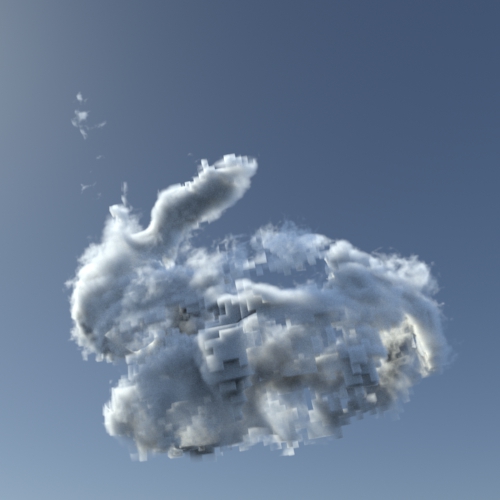

Interpolation

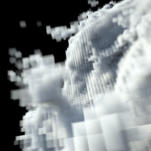

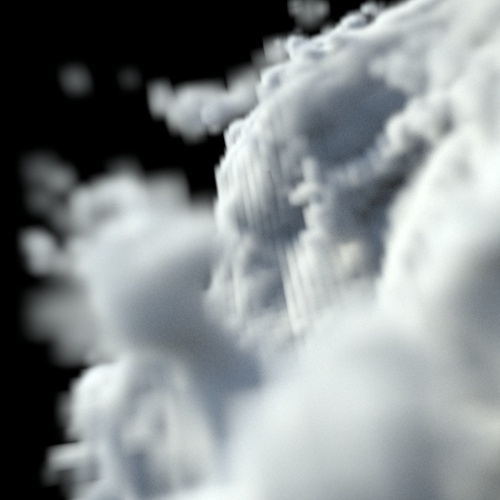

The voxel interpolation to use when sampling the volume data using named channels.
| closest | trilinear (default) | tricubic |

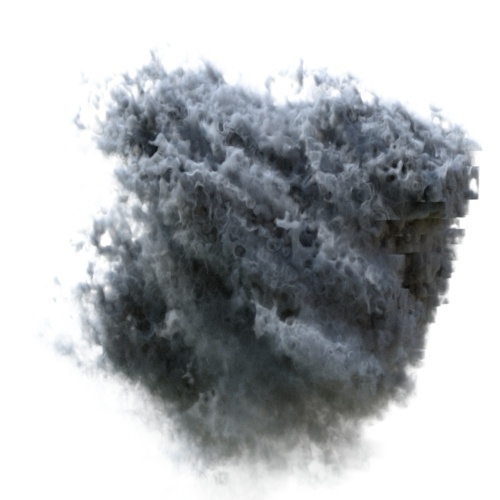

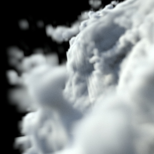

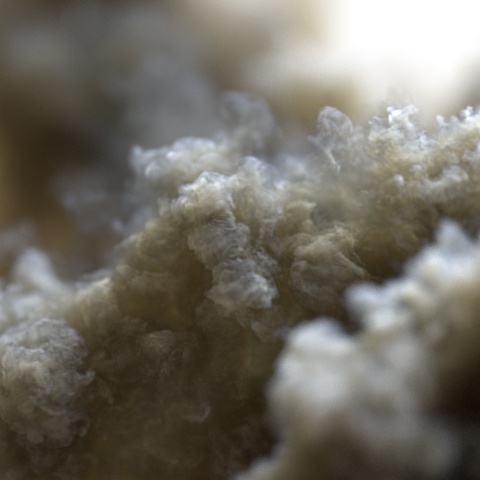

Displacement

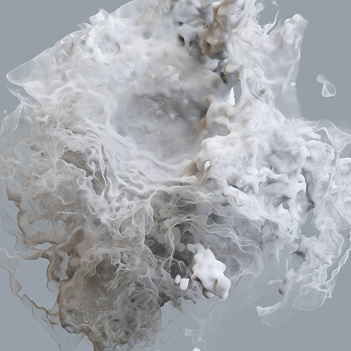

Connect a noise texture or other shaders here to displace the volume, similar to displacement on surfaces. This can be used to add additional detail to the volume or to warp it. The connected texture will be applied as an object space offset to the volume sampling position, for all volume channels.
| No displacement | Noise -> Displacement |
When using the noise shader with displacement, ensure that its mode is set to vector.
| Mode: scalar (default) | Mode: vector |
Noise shaders -> displacement
When using displacement, ensure that the Volume Padding of the volume is increased to account for the increased size of the volume.
| volume padding: 0 | volume padding: 10 |

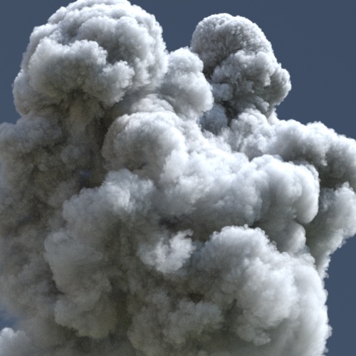

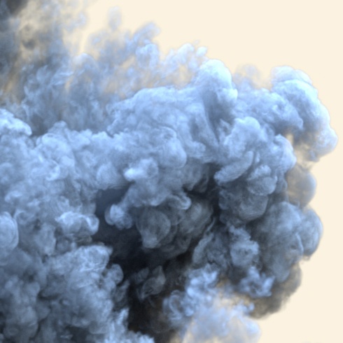

Scatter
Weight
The brightness of the volume under illumination. This is the ratio of light that is scattered rather than absorbed, for energy conservation values in the range 0..1 must be used.
| 0.1 | 0.5 | 1 (default) |
Color
The color of the volume under illumination.
| white (default) | light orange tint |

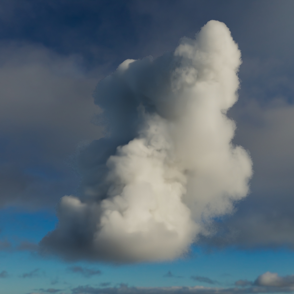

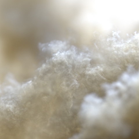

Scatter Diffusion
The scatter diffusion controls accelerate scattering in volumes and can increase the amount of light scattering in volumes without increasing volume bounces and without adding energy.
Diffusion
Accelerates scattering in volumes. This can increase the amount of light scattering in volumes without increasing volume bounces and without adding energy.
| 0 (default) | 0.5 | 1 |
Diffusion Bias
Push or pull values by altering the slope of the scatter diffusion curve at the beginning of the range. Bias values below 0.5 decrease the slope and lower values overall. Above 0.5, the slope is higher and value grow more quickly. A value of 0.5 has no effect.
| 0.15 (default) | 0.3 | 0.6 | 0.9 |
Diffusion Gain
Increase or decrease the slope of the scatter diffusion curve the mid range values. Gain values below 0.5 increase the contrast whereas values above 0.5 flatten the mid range values. A value of 0.5 has no effect.
| 0.1 | 0.5 (default) | 0.9 |
Diffusion Roughness
Accelerates scattering further on anisotropic volumes. This can help achieve realistic looking clouds without raising the number of volume bounces too much.
| 0.1 | 0.5 | 1 |

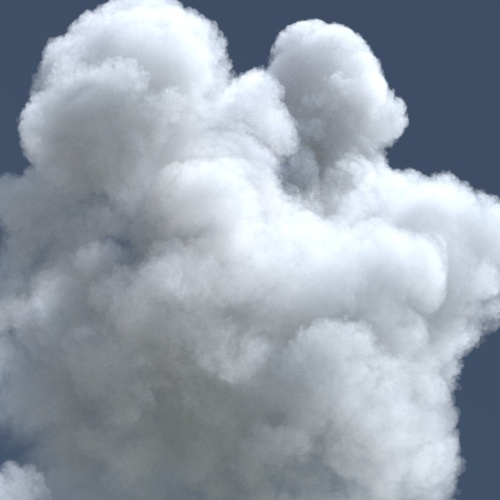

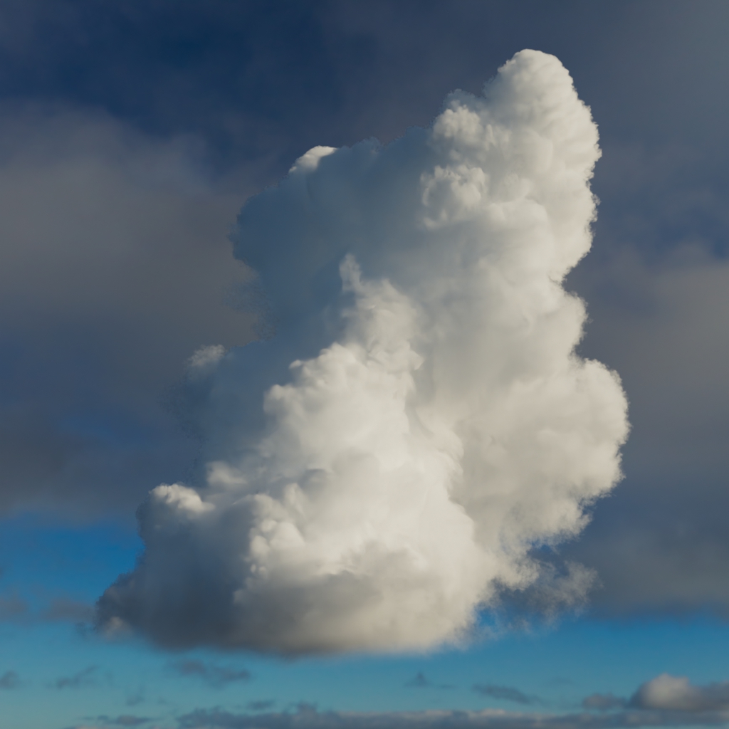

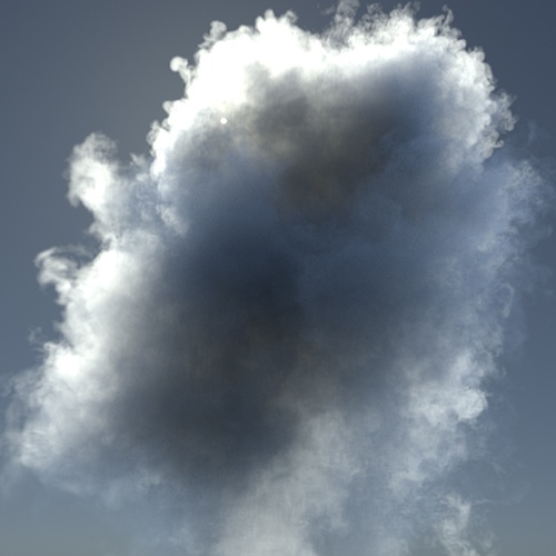

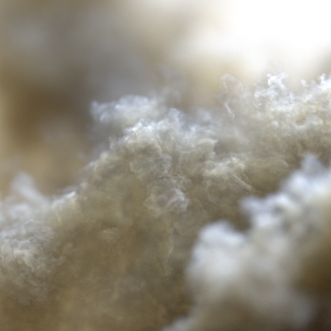

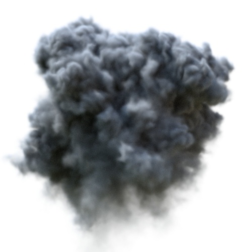

Anisotropy
The directional bias, or anisotropy, of the scattering. The default value of zero gives isotropic scattering so that light is scattered evenly in all directions. Positive values bias the scattering effect forwards, in the direction of the light, while negative values bias the scattering backward, toward the light. This shader uses the Henyey-Greenstein phase function.
Note that values very close to 1.0 (above 0.8) or -1.0 (below -0.8) will produce scattering that is so directional that it will not be very visible from most angles, so such values are not recommended.
| -0.75 | 0 (default) | 0.5 |

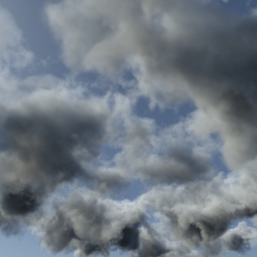

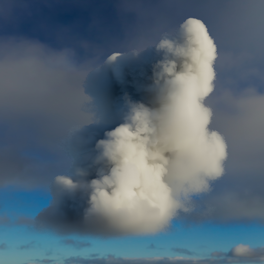

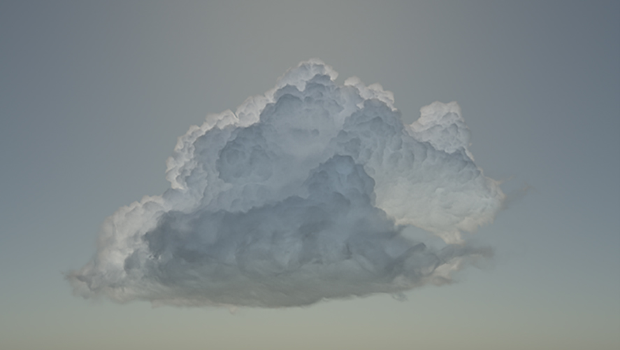

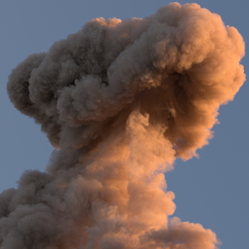

Secondary Mix
The anisotropy for the optional secondary Henyey-Greenstein phase function lobe, which is blended linearly with the primary lobe (controlled by the Scatter Anisotropy parameter). This allows the phase function to include both forward and back-scattering lobes, which can improve the realism of cloud renderings.
The cloud on the left (below), using the default anisotropy (0) settings, does not show much forward scattering. The center image shows a strong "silver lining" at the rim of strongly forward scattered light from the sun behind. The cloud on the right adds a secondary phase function lobe which fills in the bulk of the cloud with back-scattered light while maintaining the silver lining.
| anisotropy 1: 0, anisotropy 2: 0 (default) | anisotropy 1: 0.7, anisotropy 2: 0.7 | anisotropy 1: -0.4, anisotropy 2: 0.7 |
(all images have secondary anisotropy mix: 0.5)
The figure below shows the full parameter space of the dual-phase function model (each cell shows the phase function shape for a given combination of lobe anisotropies, which varies as the lobe mix weight is animated). The blue curves correspond to the old single lobe model.
Secondary Anisotropy
The anisotropy for the optional secondary Henyey-Greenstein phase function lobe, which is blended linearly with the primary lobe (controlled by the Scatter Anisotropy parameter). This allows the phase function to include both forward and back-scattering lobes, which can improve realism of cloud renderings.
Anisotropy (primary or secondary) should not exceed about 0.8 at the maximum or be less than -0.8 at the minimum, otherwise, noise and fireflies will appear.

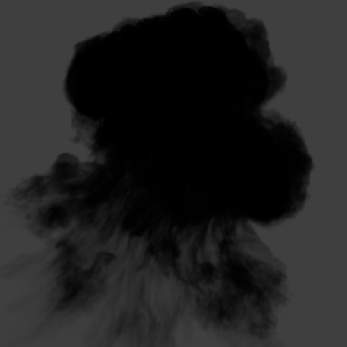

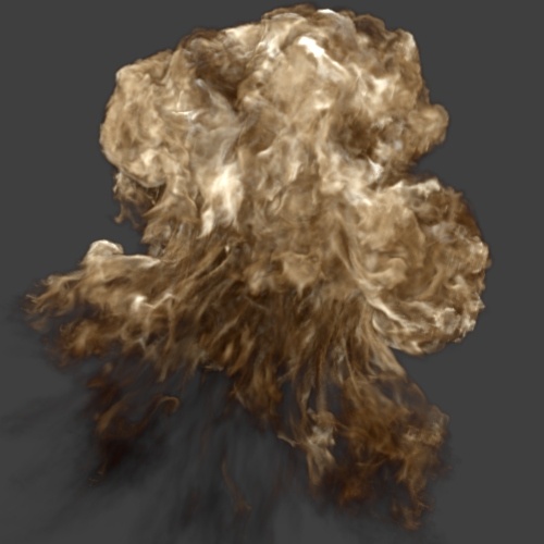

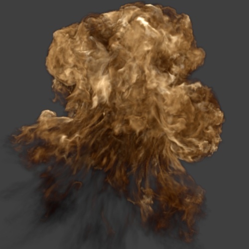

Transparent
Weight
Additional control over the density of the volume, to tint the color of volume shadows and objects seen through the volume.
| grey (default) | purple |
Depth
Additional control over the density of the volume, to control the depth into the volume at which the transparent color is realized.
| 1 (default) | 2 | 3 |

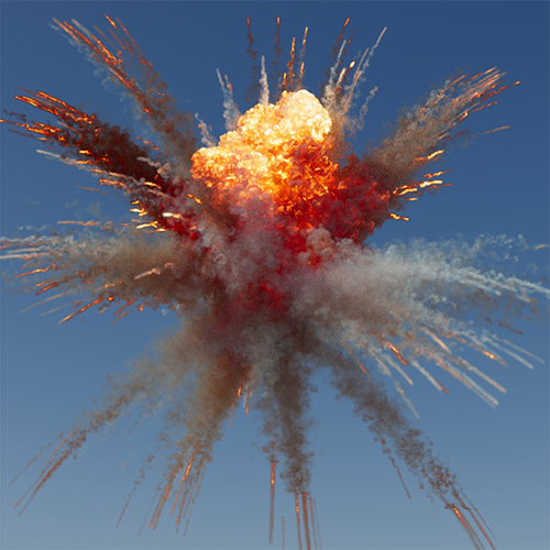

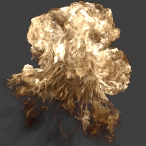

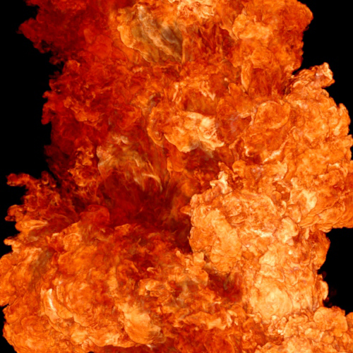

Emission
Mode
- None: emit no light.
- Channel: emit light using a specified emission channel, or using a shader connected to the emission rate or color parameters.
- Density: emit light using the density channel, modulated by an optional emission channel.

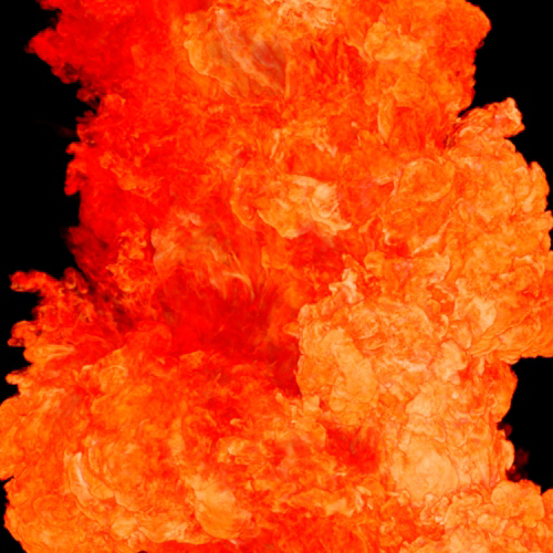

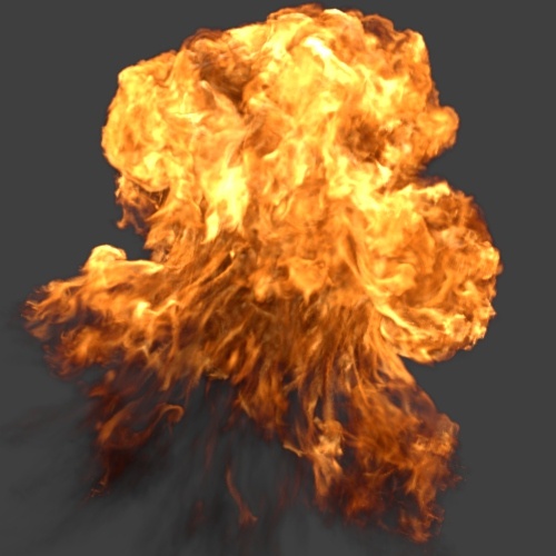

- Blackbody: emit color and intensity based on temperature, for rendering fire and explosions.
| none | density | channel | blackbody (default) |
Scaling
This controls how volume emission is scaled by the properties of the emitting medium.
- None: no dependence on medium. This is unphysical but included for backward compatibility.
- Opacity: the emission is based on density and transparency and scaled appropriately to the opacity of the resulting volume. This is physically accurate for blackbody if the scattering color is black.
- Thermodynamic: this mode is the most physically correct (for blackbody emission) as it also takes into account scattering color, since according to thermodynamics volumes with higher scattering albedo emit less blackbody radiation. For example, burning hydrogen produces steam but barely emits blackbody radiation while sooty smoke readily does.
| none | opacity | thermodynamic |
Weight
Emission is the rate at which a volume emits light. If a density channel, emission channel, or blackbody channel is used for emission, this acts as a multiplier to decrease or increase the emission. Alternatively, if no so such channel is used, a shader like a volume sample or a procedural texture may be connected to this parameter to control where light is emitted.
| 0.1 | 0.3 | 1 (default) |
(emission mode: blackbody)
Volumes can only receive indirect lighting from other emissive volumes when the Volume Ray Depth is above 0.

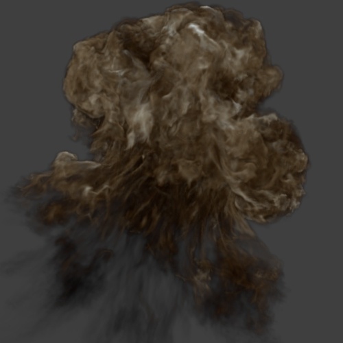

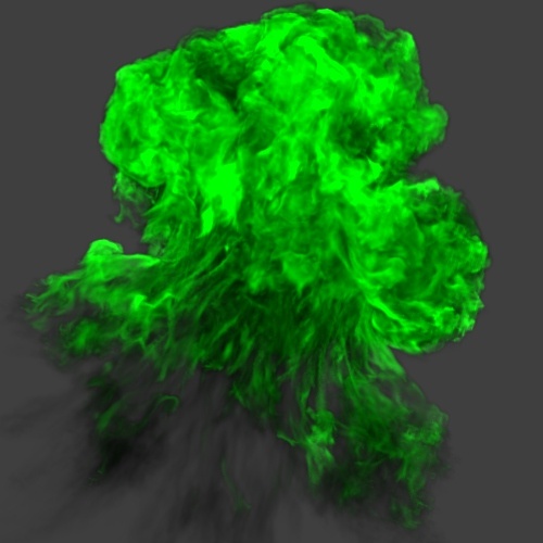

Color
A color to tint (multiply to) the emission.
| white (default) | green |
Channel
In Channel emission mode, the emission channel to sample the emission rate from.
When not empty, this channel will be used to sample the emission values for the volume instead of the Emission parameter. The sampling tab has additional parameters to control how data is sampled from volume channels.
When using the Channel emission mode, ensure that the emission attribute is driven by a VDB grid. If it is a fixed parameter value, you may get artifacts.

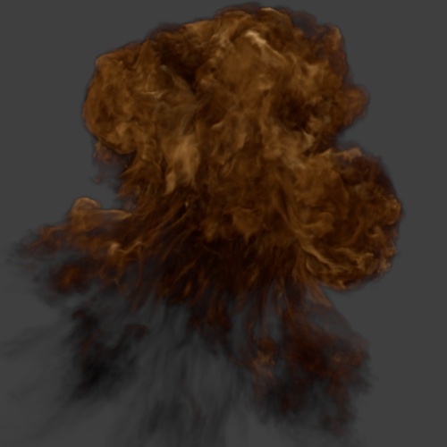

Temperature
Temperature
If a blackbody channel is used, this acts as a multiplier for the blackbody temperature. Alternatively, a shader like a volume sample or a procedural texture may be connected to this parameter to control the blackbody temperature.
| 0.5 | 0.75 | 1 (default) |
Channel
In the Blackbody emission mode, the temperature channel to read from the volume object. Typically the temperature channel comes from a pyro physics simulation.
Blackbody Kelvin
The multiplier for the temperature from the temperature volume channel. Usually, the temperature is stored in a 0..1 range, and this parameter can be used to scale it to a temperature in Kelvin.
| 2500 K | 5000 K (default) | 7500 K |

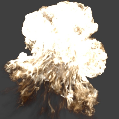

Blackbody Intensity
Controls the intensity of the Blackbody emission. For physically correct results intensity 1 must be used. This can result in extremely bright light, however, and lower values may be used to reduce the intensity.
The Blackbody Intensity control can be dialed above 1 for convenience.
Blackbody Contrast
The Blackbody Contrast parameter (non-physically) reduces the brightness difference between parts of the volume at different temperatures, which can be useful for artistic purposes. This tends to bring out the blackbody colors more vividly (though note that only value 1 is physically correct).
