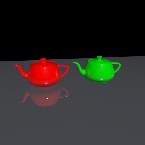

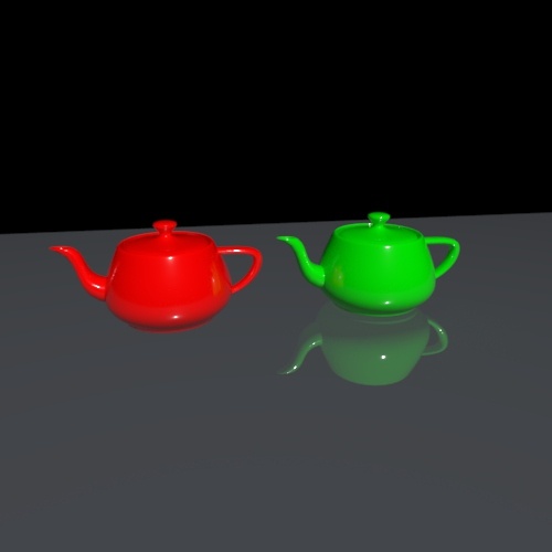

| enabled (Trace Set: green) | disabled (Trace Set: green) |
Trace Set assigned to plane
