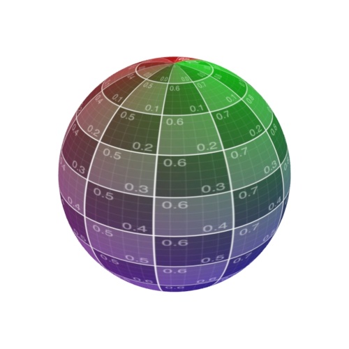

Spherical
Places the texture inside a sphere and projects it onto the object.

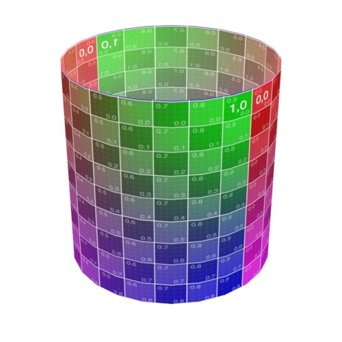

Cylindrical
Places the texture inside a cylinder and projects it onto the object.

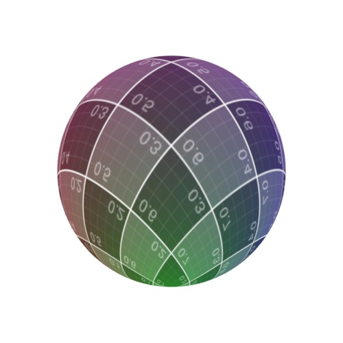

Ball
Places the texture inside a ball and projects it onto the object.

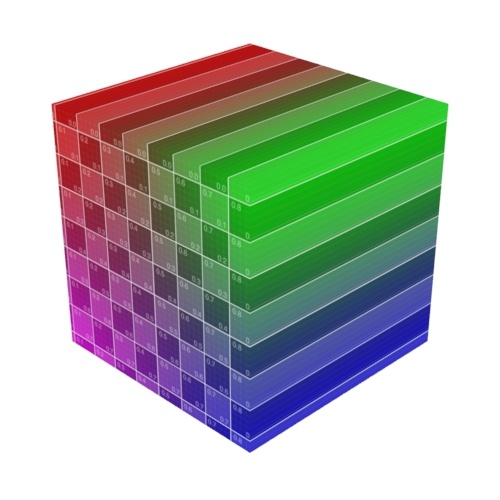

Cubic
Places images on each plane and projects them onto the object.

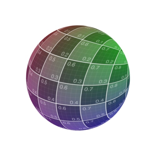

Shrinkwrap
Uses spherical mapping, but truncates the corners of the map and joins them all at a single pole, creating only one singularity (useful when you want to hide the mapping singularity).

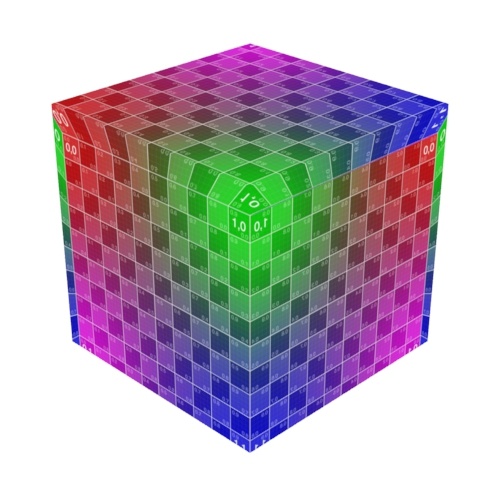

Coord Space
Specifies the coordinate space to use. These include World, Object, Pref, and UV space coordinates. Pref is short for 'vertex in reference pose'. The plugin can pass these vertices to Arnold (in addition to the regular, deformed vertices), which can, in turn, be queried by the noise shader so that the noise 'sticks' to the reference pose and does not swim as the mesh deforms.
- Object space: where points are expressed relative to the local origin (center) of the object.
- World space: where points are relative to the global origin of the scene.
- Pref: which isn’t really a space, but rather a reference to a bind pose (note Pref does not work with NURBS surfaces).
- UV: for texturing using the object’s local UV coordinates. Note that this calls the faster 2D noise API, not the 3D noise like all other coordinate spaces.
| coord space: object (default) | coord space: uv |

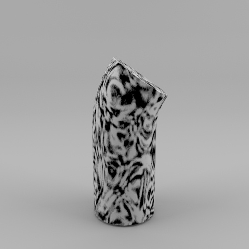

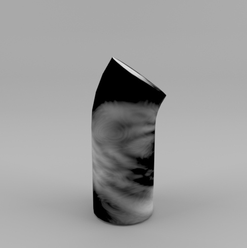

Below are animations that show Pref space coordinates in use with a deforming object. Note how the texture sticks to the object when using Pref space coordinates, compared to Object/World space coordinates, where the texture swims.
| Using world/object space: texture swims | Using Pref space: fixes texture swimming |
