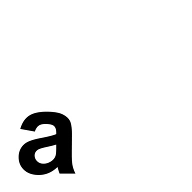

Scale
Controls how much of the surface will be covered by the texture. Its default values, (1, 1, 0) will cover the entire surface. Reduce these values to make the texture smaller. For example, if you change the Scale U to 0.5, then the texture will only cover half the surface in the U direction.
Translate
Controls the position of the texture, relative to the Pivot frame value (default 0, 0, 0). Increase these values to move the texture frame away from the Pivot. For example, when Translate Frame U is set to 0.5, the texture will be shifted halfway along the surface.

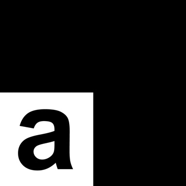

Wrap U
Controls how a texture repeats on a large surface. Choose between periodic, color, clamp, and mirror. The default wrap mode is Periodic. See the different modes below.
Wrap V
Controls how a texture repeats on a large surface. Choose between Periodic, Color, Clamp and Mirror. The default wrap mode is Periodic.
| periodic (default) | color (black) | clamp | mirror |
Wrap Color
Defines the color used in the Color wrap mode. Linking a shader to this parameter is also allowed.

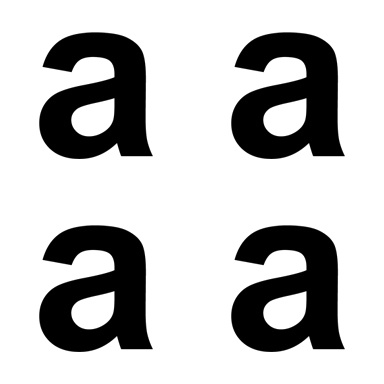

Repeat
Controls how many times the texture is repeated.

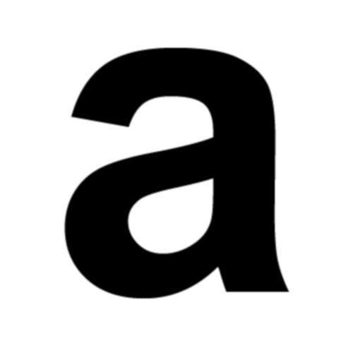

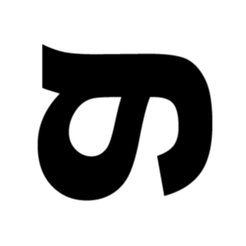

Offset
Swaps the axes.
| Disabled (default) | Enabled |

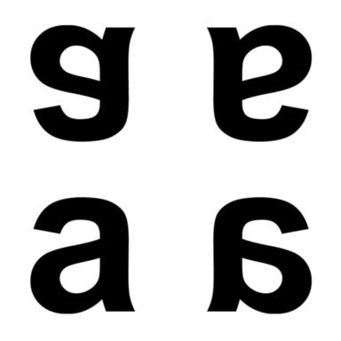

Mirror U
Controls how texture tiles are placed beside each other. When enabled, each copy of the texture will be the mirror image of the ones on the U side of it, with their shared edge being the (V) axis of reflection.
Mirror V
Controls how texture tiles are placed beside each other. When enabled, each copy of the texture will be the mirror image of the ones on the V side of it, with their shared edge being the (U) axis of reflection.

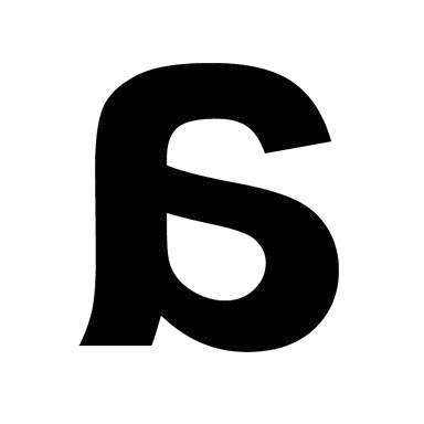

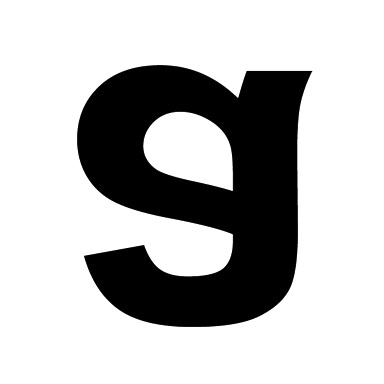

Flip U
Flip (mirror) the image in the horizontal direction.
| disabled (default) | enabled |
Flip V
Flip (mirror) the image in the vertical direction.

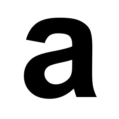

Swap UV
Swaps the axes.
