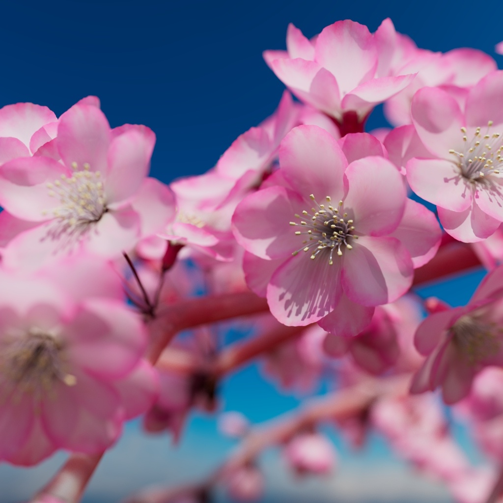

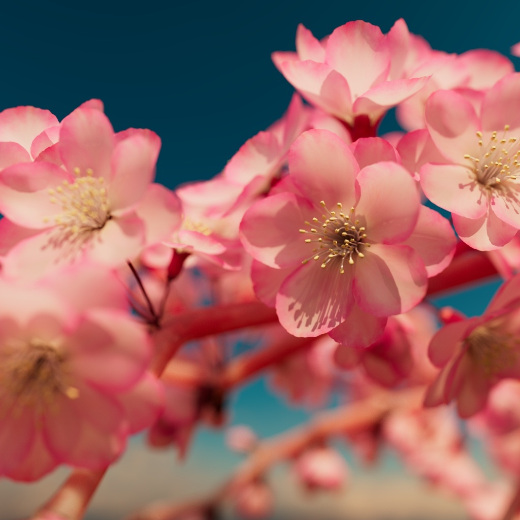

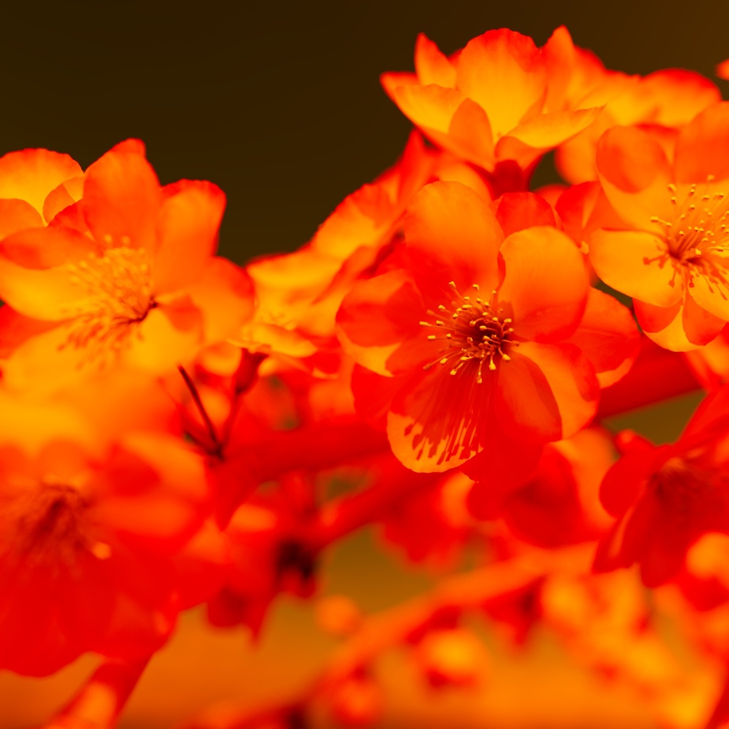

Use the white balance imager to correct the image's white balance with reference illuminants, custom colors, or a blackbody temperature.

Mode
White balance mode.
Temperature
Temperature for black body mode.
| Light Type | Color Temperature in Kelvin | Hue |
| Overcast daylight | 6000 K | 130 |
| Noontime sunlight | 5000 K | 58 |
| White fluorescent | 4000 K | 27 |
| Tungsten/halogen lamp | 3300 K | 20 |
| Incandescent lamp (100 to 200 W) | 2900 K | 16 |
| Incandescent lamp (25 W) | 2500 K | 12 |
| Sunlight at sunset or sunrise | 2000 K | 7 |
| Candle flame | 1750 K | 5 |
| 1750 | 2000 | 2500 | 2900 | 3300 |
| 4000 | 5000 | 6000 | 6500 |
