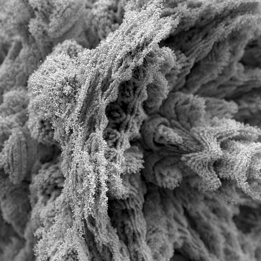

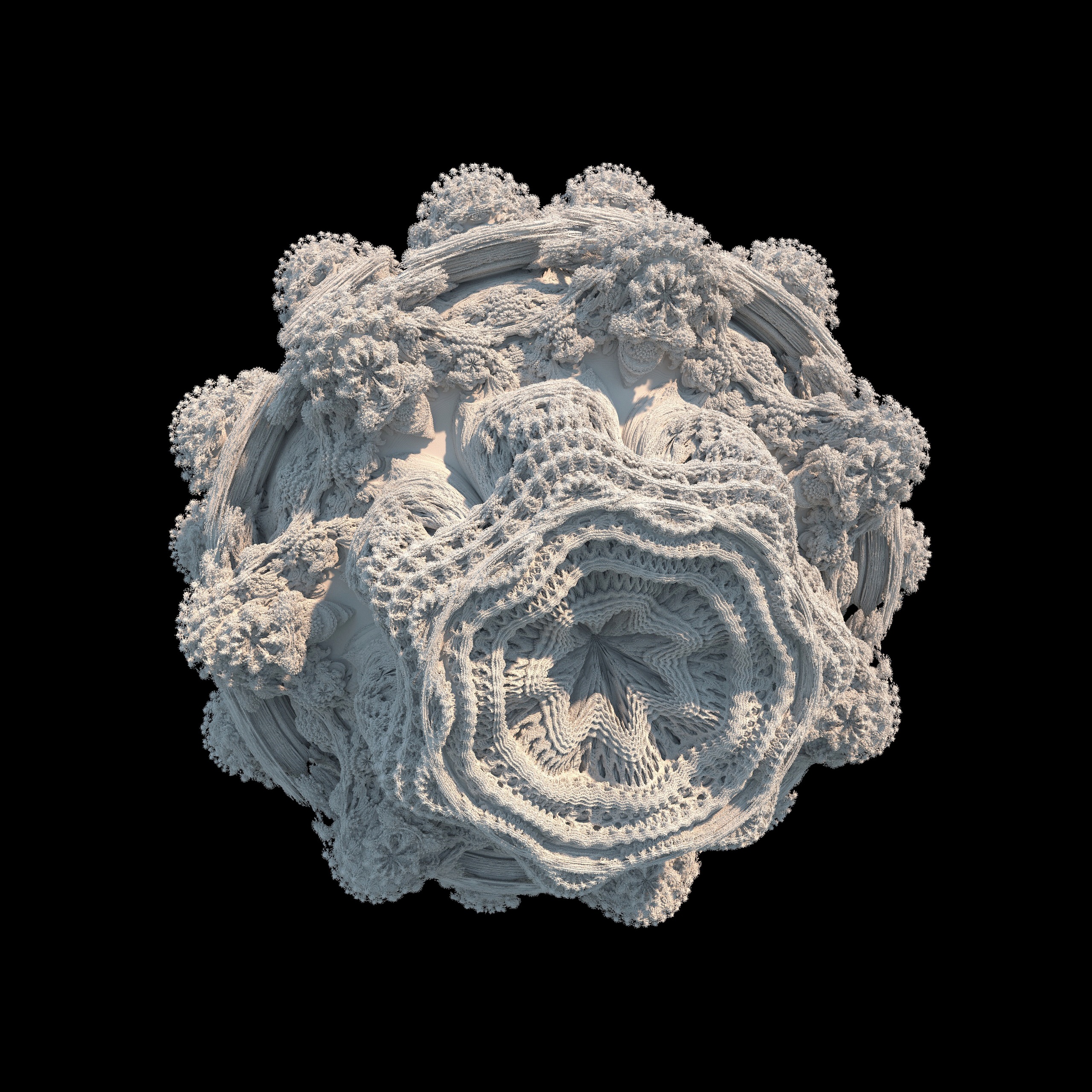

The Mandelbulb
In our example, we are generating a "Mandelbulb" 3D version of the Mandelbrot and Julia sets. This algorithm involves iterating a function (Z^n+C) and seeing if it exits a sphere of radius 2; if it stays inside for a set number of steps, it is considered a "prisoner point" and a small sphere is put there. Rendering a Mandelbulb as a dense grid of spheres is neither the most elegant nor the most efficient way to display this mathematical entity; we are just using this as a method to create large amounts of data for this tutorial.
render example

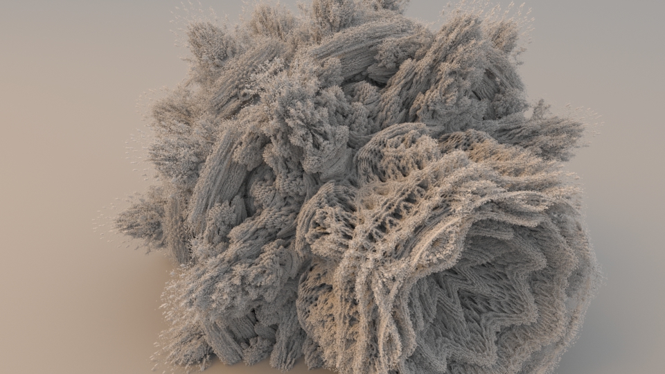

Example Scene
The following .ass file generates an image similar to the one at the top of this page:
mandelbulb.ass

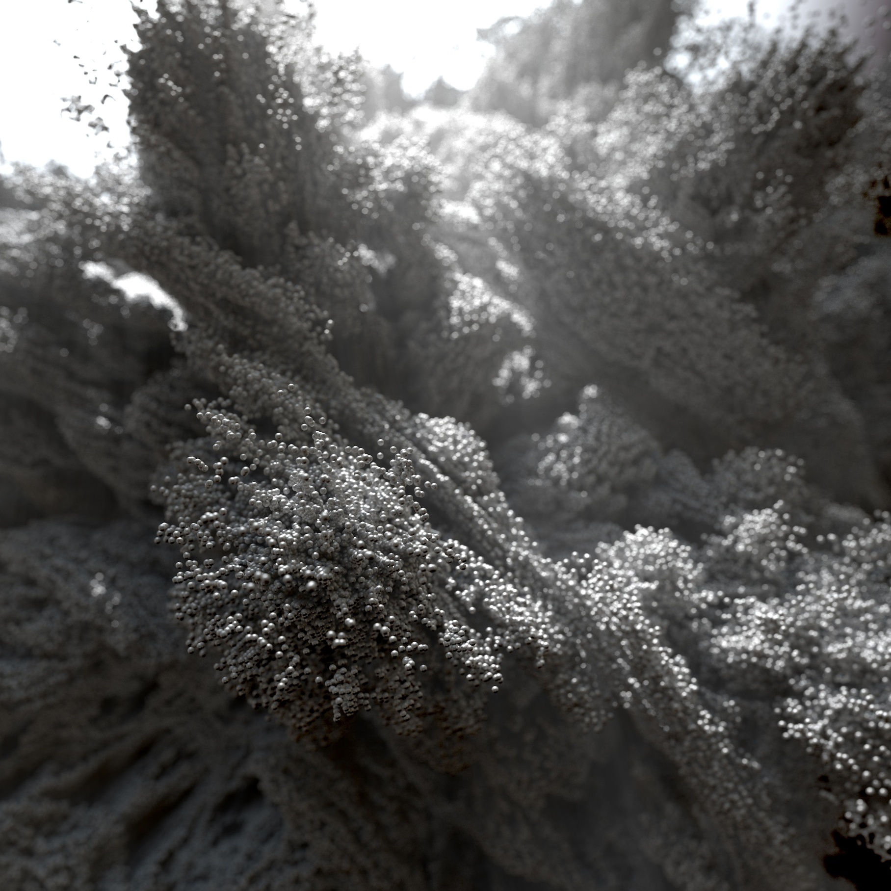

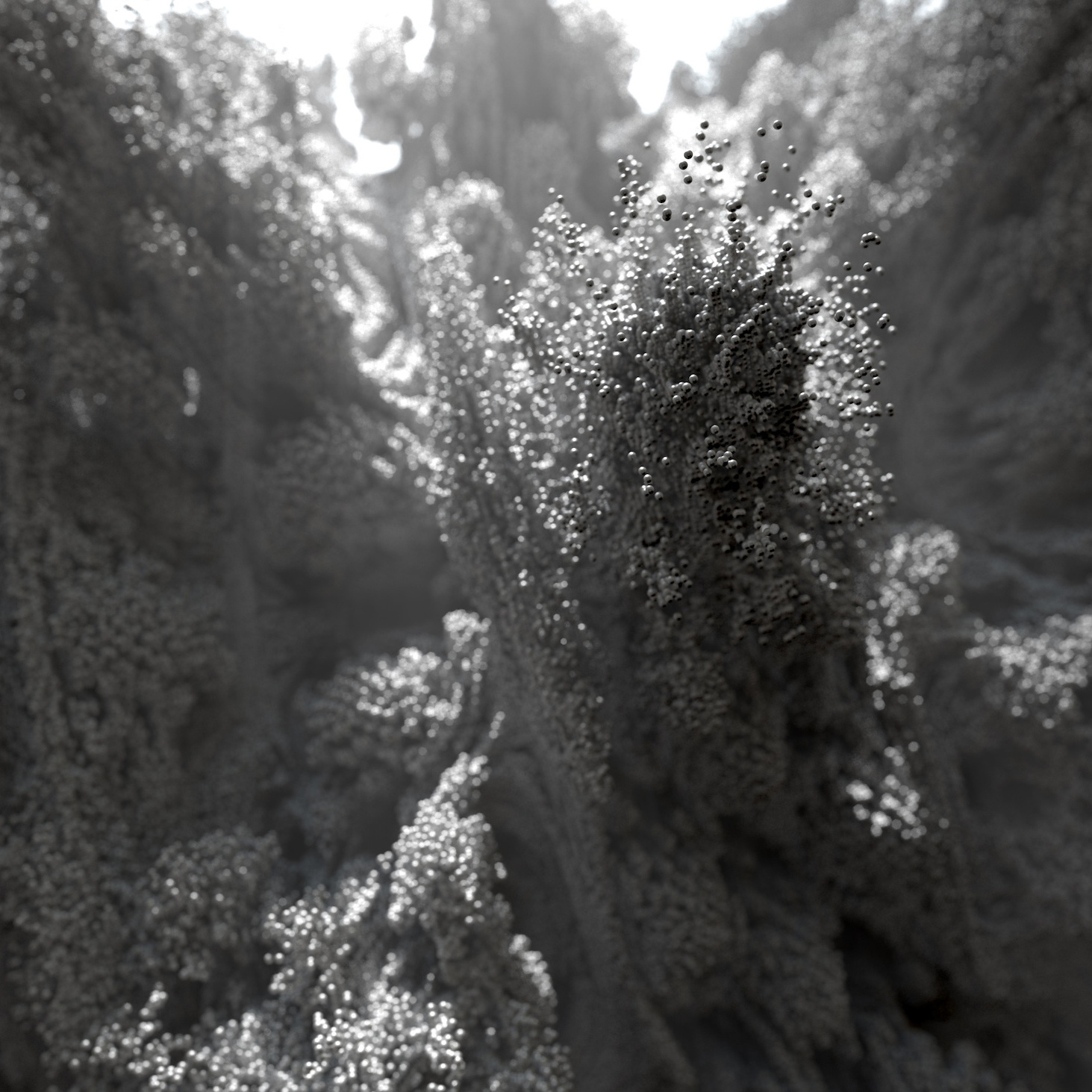

Here is a high-resolution, 2.5 billion sphere render by Thiago Ize and some close-ups rendered by Lee Griggs.
