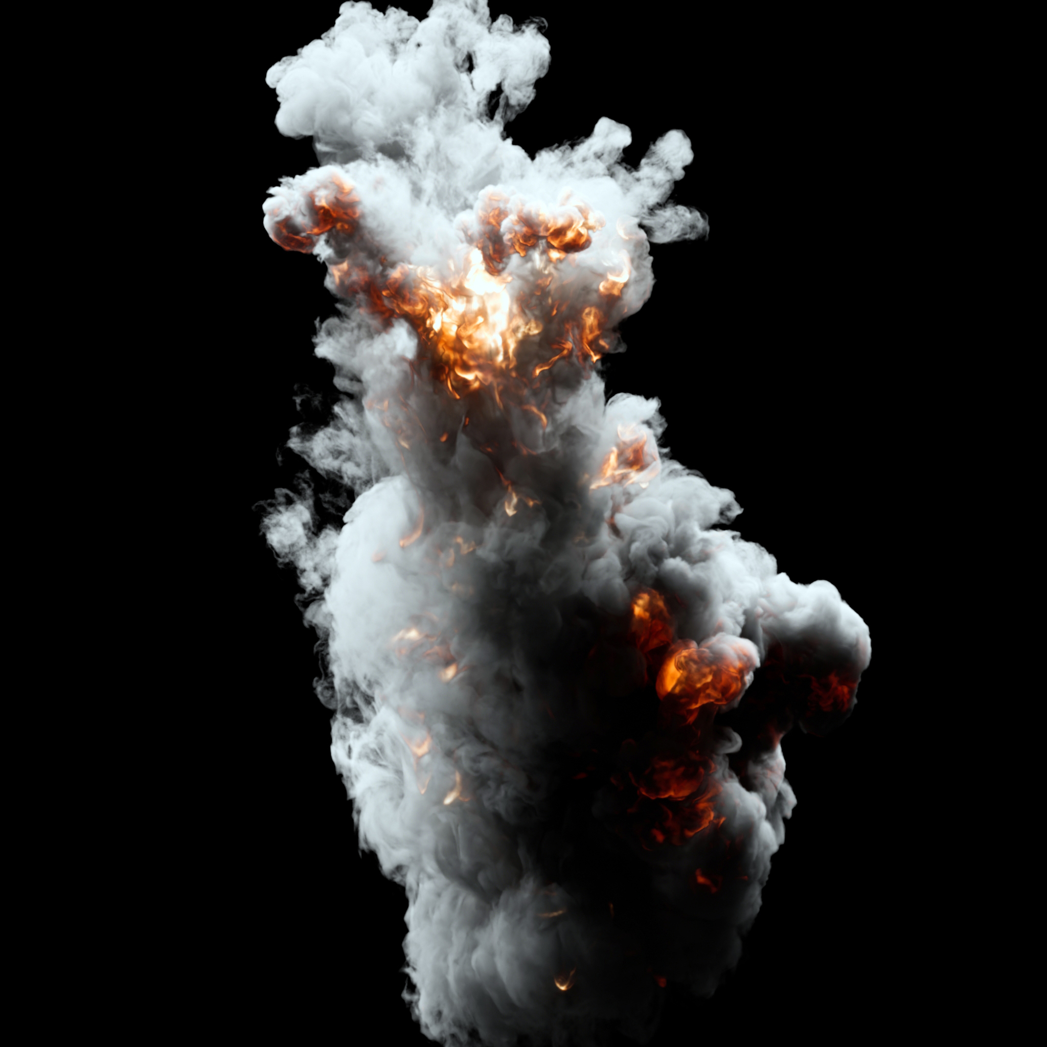

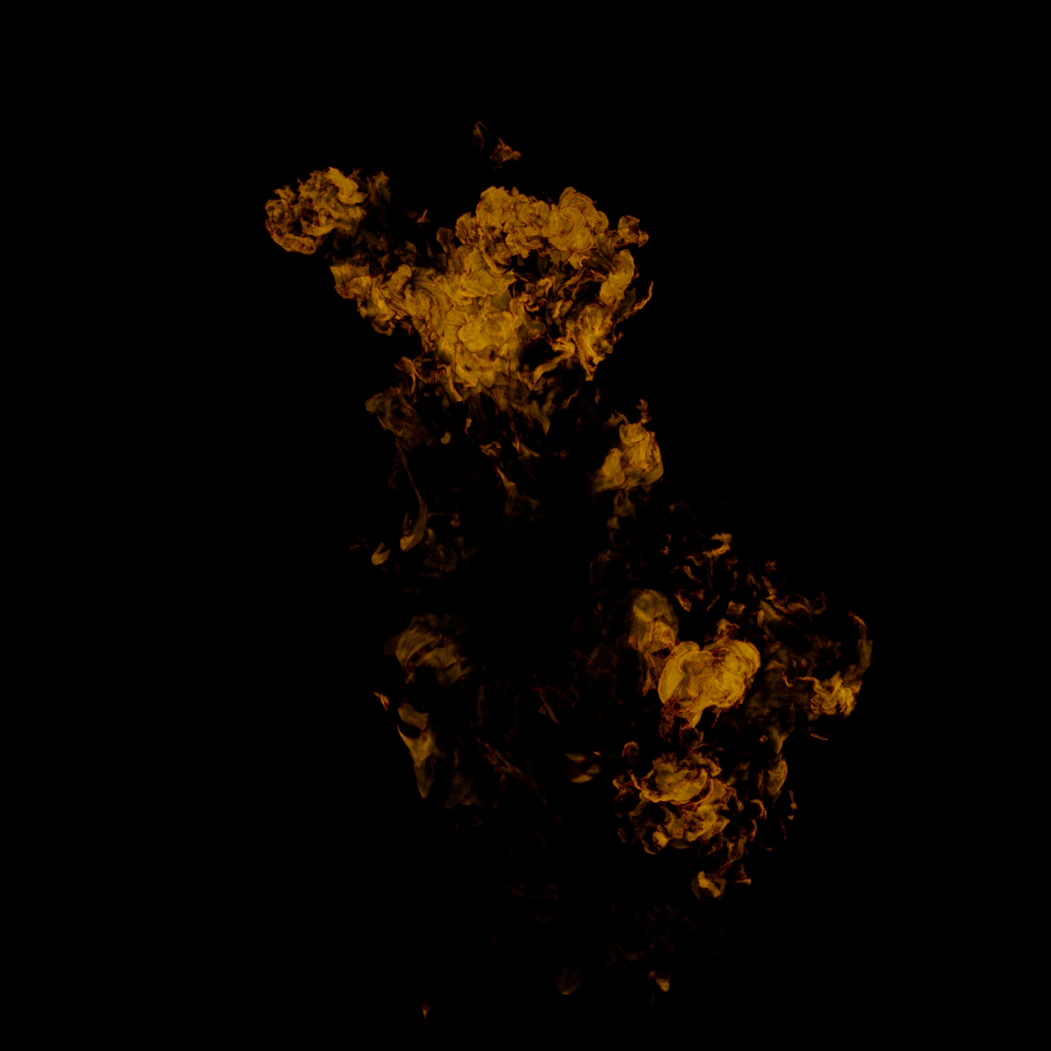

- Custom AOVs for volume shaders: The
aov_write_rgb,aov_write_float, andaov_write_rgbashader nodes can now be used in volume shader networks, just as they already work for surface shaders. Previously, custom AOVs were silently ignored in volume contexts. The volume raymarcher now collects AOV closures at each step and integrates them using Beer-Lambert weighting, producing physically consistent AOV outputs. (ARNOLD-6548)- Both flat (EXR, TIFF) and deep EXR outputs are supported.
- A warning is logged when
aov_write_rgbnodes with conflictingblend_opacitysettings are connected to both surface and volume shaders writing to the same AOV name. - There is approximately a 16% overhead with two active volume AOVs at fine step sizes (
step_size=0.01).
| No Emission | Custom 'temperature' AOV mask | Beauty |

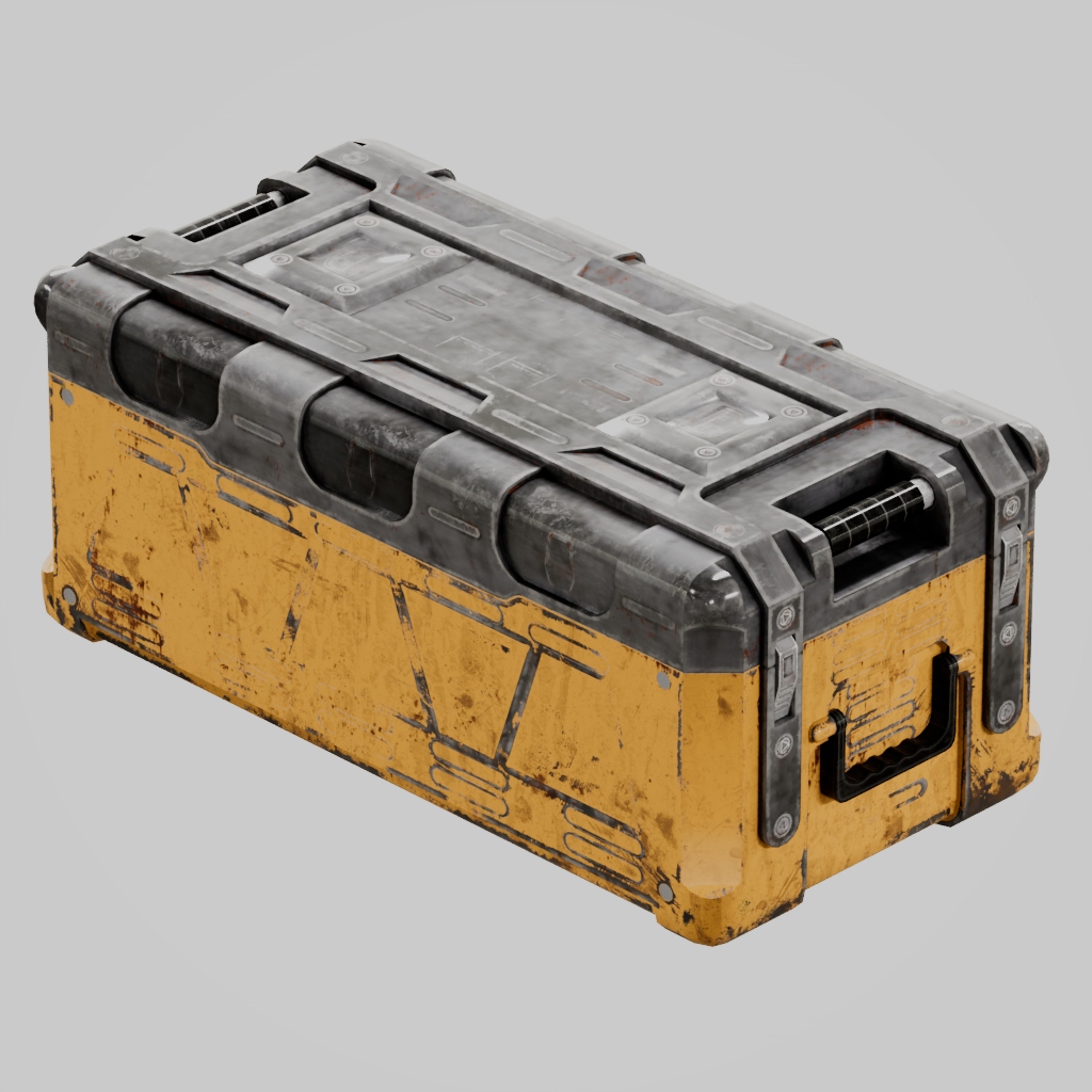

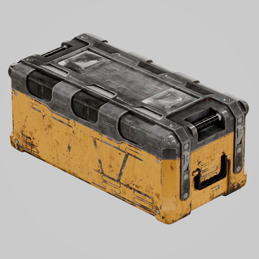

- New tangent_space_type option for normal_map: A new
tangent_space_typeparameter adds support for MIKKTSpace normal mapping. Thestandardmode preserves the previous behavior, while themikkmode importsnormal,tangent, andbitangentgenerated with MIKKTSpace in DCC tools such as 3ds Max and evaluates the normal map using MIKKTSpace for consistent shading across applications. (ARNOLD-8377)
| Standard | MIKKTSpace |

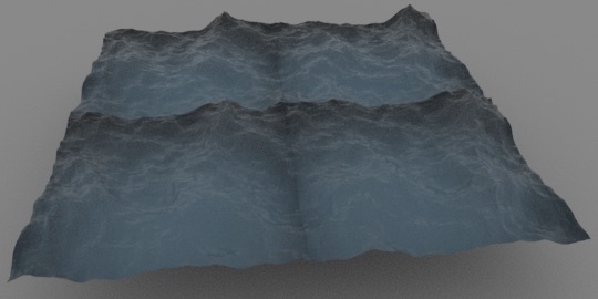

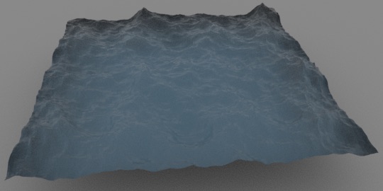

nearest_pointsshader has a newquery_positionparameter, which allows you to link to an input and customize the point where the point cloud is queried. When unlinked,sg->P(world-space shading position) is used instead. (ARNOLD-17360)New interior_set string user data: The new
interior_setattribute enables coherent scattering (such as transmission and SSS) across shapes that share the same set name. This allows smooth propagation of scattering between separate shapes, such as large ocean surfaces modeled as multiple tiles.interior_setreplacessss_setname, althoughsss_setnameremains supported for now. If both attributes are present on the same object,interior_settakes precedence. (ARNOLD-9038)
without interior_set |
with interior_set |
