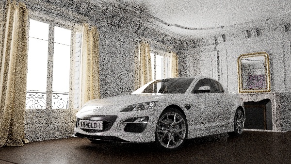

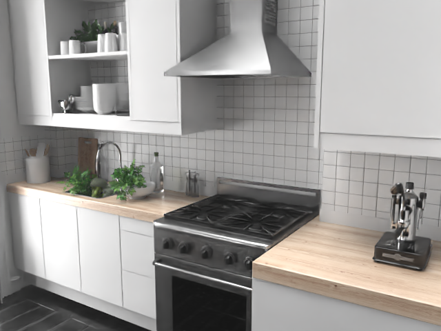

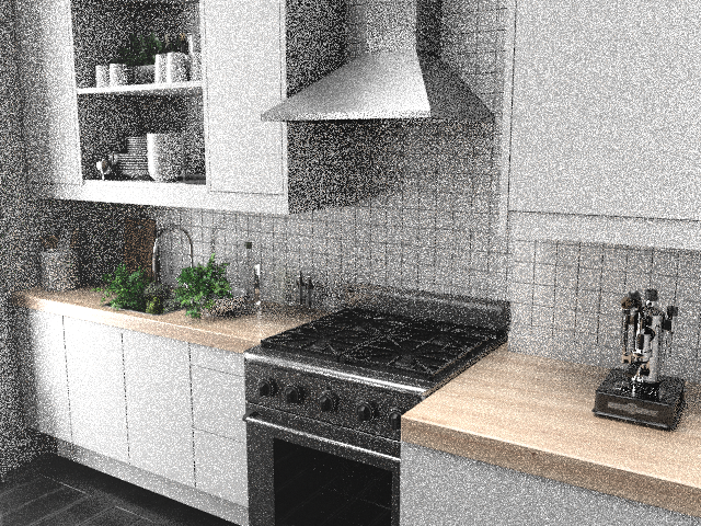

  • Open Image Denoise imager: Intel ® 's Open Image Denoise (OIDN) is a fast, AI-accelerated denoiser that runs on CPU that has been integrated into Arnold as the imager_denoiser_oidn imager as an additional denoising option. (ARNOLD-8677).
Undenoised denoised using imager_denoiser_oidn
OIDN denoiser. Rollover image to view without denoising.
Sampling settings: camera (AA): 3, diffuse: 2, specular: 2, transmission: 2.

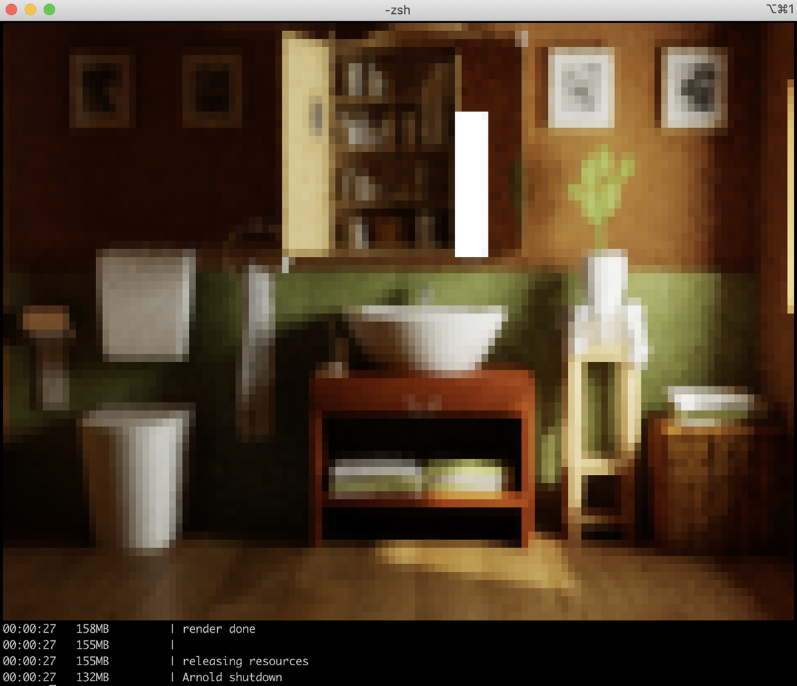

  • kick ascii render mode: kick -ascii allows rendering directly into the terminal. This requires a 24-bit terminal with UTF-8 support. The windows terminal, most Linux terminals, and iTerm support this; Apple's Terminal does not. This will change the resolution of the render to fit within the console, so any images written to disk will likely be very small. Because it is so low res, telling kick to use a small bucket size is recommended, for instance by passing -bs 16 to kick. This can be useful for checking if a render on a remote machine is working (ARNOLD-11146).
