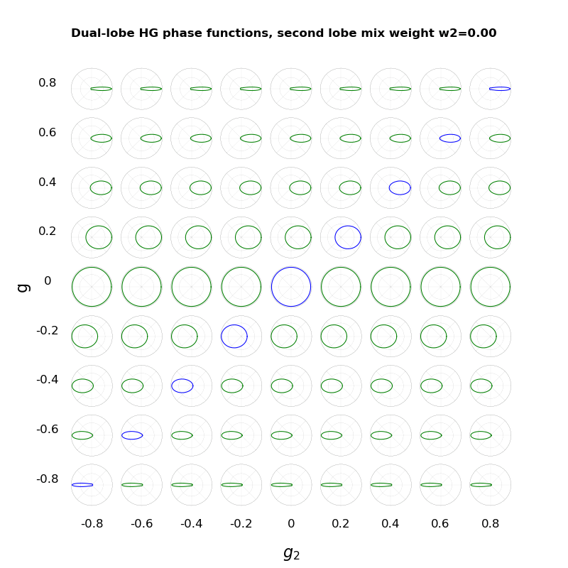

  • Dual-lobe phase function for standard_volume: A new phase function model has been implemented for the standard_volume shader, which is a mixture of two lobes rather than a single lobe as before. This provides a more realistic approximation to the physical phase function of scattering media such as clouds. The new model adds two new parameters, scatter_secondary_anisotropy (in [-1,1]) and scatter_secondary_anisotropy_mix (in [0,1]). (ARNOLD-9335)

    The image below shows the full parameter space of the new dual-phase function model (each cell shows the phase function shape for a given combination of lobe anisotropies, which varies as the lobe mix weight is animated). The blue curves correspond to the old single lobe model.

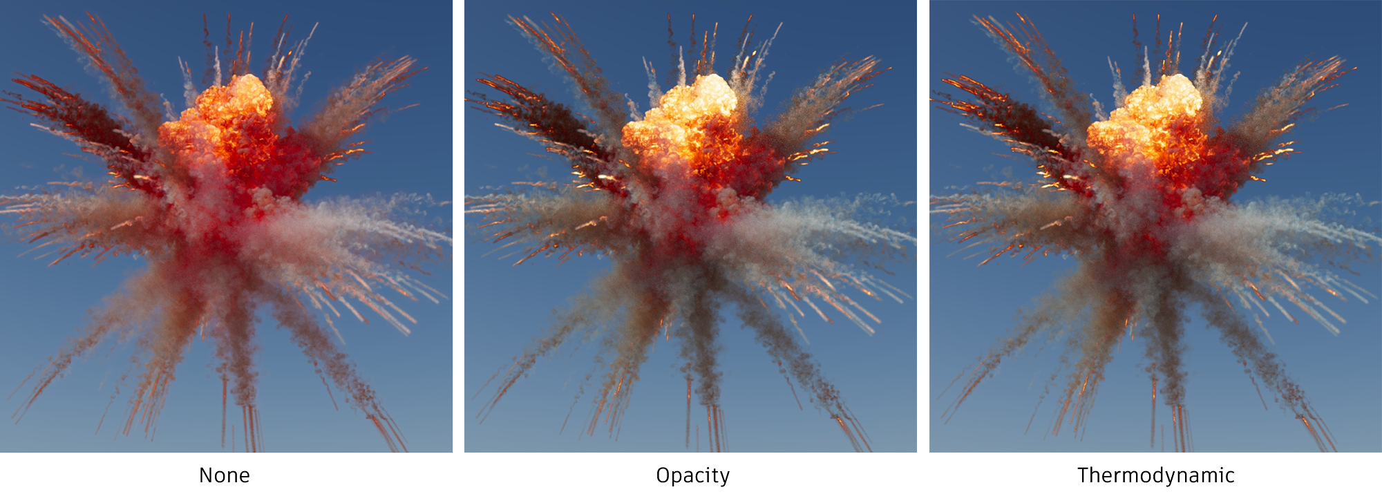

  • Physically correct volume emission scaling: The standard_volume shader has been improved to support scaling of volumetric emission in a more physically correct manner (via the emission_scaling option). The "opacity" emission scaling mode is based on density and transparency and scaled appropriately to the opacity of the resulting volume. This is physically accurate for blackbody if the scattering color is black. The "thermodynamic" emission scaling mode is the most physically correct as it also takes into account scattering color, since according to thermodynamics volumes with higher scattering albedo emit less blackbody radiation. For example, burning hydrogen produces steam but barely emits blackbody radiation while sooty smoke readily does. This mode is most useful when mixing different types of volumes with varying scattering properties. (ARNOLD-11701)
    The images below show the effect of the scaling mode on blackbody emission. The difference between opacity and thermodynamic modes here is that in thermodynamic mode the white, highly scattering smoke does not emit, while the black smoke does (which is a slightly subtle effect but more physically correct). image2022-7-12_8-23-53

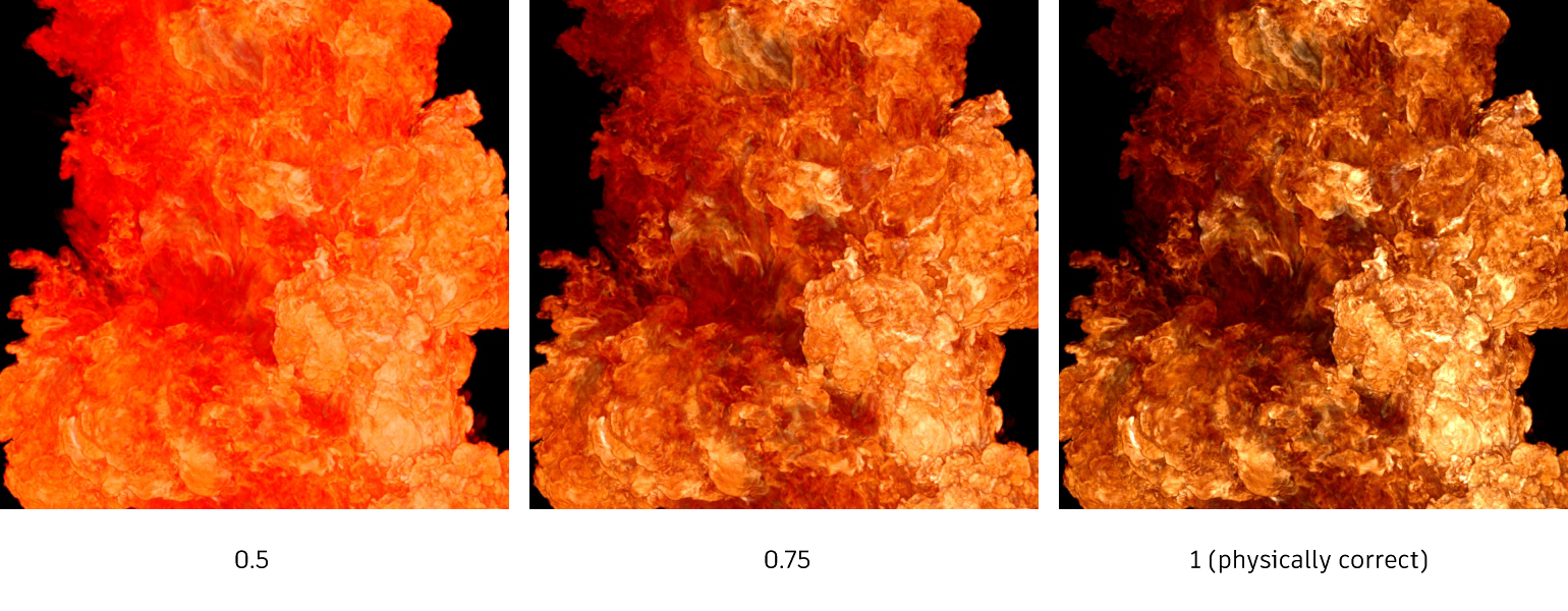

  • Other volume emission improvements: The blackbody_intensity control can now be dialed above 1 for convenience. A blackbody_contrast parameter has also been added to (non-physically) reduce the brightness difference between parts of the volume at different temperatures, which can be useful for artistic purposes (ARNOLD-11701).
    The images below show the effect of altering the new blackbody_contrast parameter. This reduces the disparity in brightness between parts of the volume at different temperatures, which tends to bring out the blackbody colors more vividly (though note that only value 1 is physically correct). image2022-7-18_12-50-48
