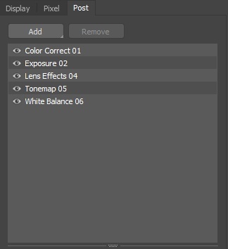

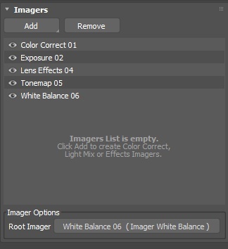

Imagers in the Arnold Render View window Imagers in the Render Setup window

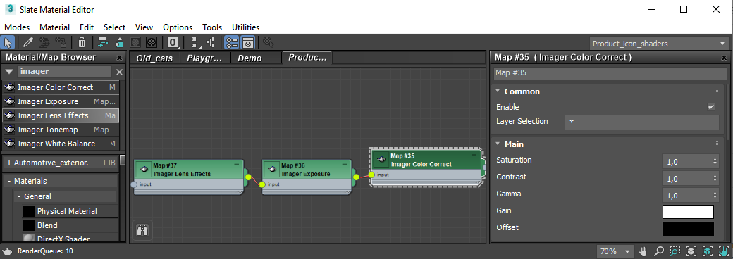

Post-processing nodes called imagers operate on pixels before the output driver. Imagers can be chained together.

Multiple imagers chained together in the Slate Material Editor
