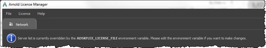

  3. If you see a Server list is currently overridden message, that means the ADSKFLEX_LICENSE_FILE environment variable is set, and Arnold is using ADSKFLEX_LICENSE_FILE to connect to the license server.
    If you want to use the Arnold License Manager to connect to a license server, you'll need to clear the ADSKFLEX_LICENSE_FILE from your system.
