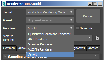

  1. Start 3ds Max.
  2. Arnold should appear as the current renderer in the Render Setup dialog (from the top menu bar, Rendering> Render Setup..., or by clicking), set Arnold from the Renderer drop-down menu.
Note how the renderer options are organized in groups (this is discussed further in sub-topics of the Arnold Render Setup page).

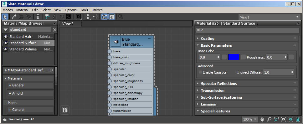

Standard Surface Shader
  • By default, the floor plane has no material assigned and renders with a default lambert shader. We will assign a standard_surface shader instead. In the Slate Material Editor window, create a standard_surface material by dragging or double-clicking it under the Arnold category in the Material/Map Browser pane on the left. Double click it in the central View window to view its parameters in the Material Parameter Editor. Assign the shader to the plane.
  • Change the standard_surface.base_color to blue.
standard_surface.base_color changed to blue

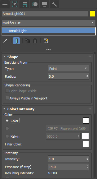

  • We can choose an Arnold light from the Lights tab in the Create Panel.
  • By default, a quad_light. Position it so that it is above and in front of all of the objects in the scene.
  • Now we need to increase the exposure of the light. Select the light, and under the Modify Panel, you should see exposure. Try adjusting its value to see the effect of the lighting in the scene.
Arnold Light Type: Point. Exposure increased to 14.

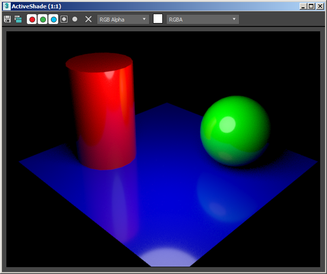

Rendering
  • Now we're ready to do a render. Start an Active Shade render by clicking on the icon. If you do not see this icon, hold down the mouse and on the flyout choose the 'ActiveShade' button.
  • You may still find that the scene is a little dark for your taste. It's worth mentioning at this point that lights in Arnold use quadratic decay by default (because that is what happens in the real world, and Arnold is designed to work with a physically accurate approach to modeling and lighting). You can also address the 'too dark' issue by altering the intensity of the light. Generally speaking, we recommend you work using the quadratic decay as it is more realistic, so you should choose intensities (and the scale of the model) accordingly, and then use the exposure setting to fine tune.
  • If you increase the Radius of the light (select the point light and increase the Radius), you get soft shadows. Increase the number of light samples for the point_light from 1 to 3 to reduce noise in the shadows.
Increasing the Radius of the light creates softer shadows

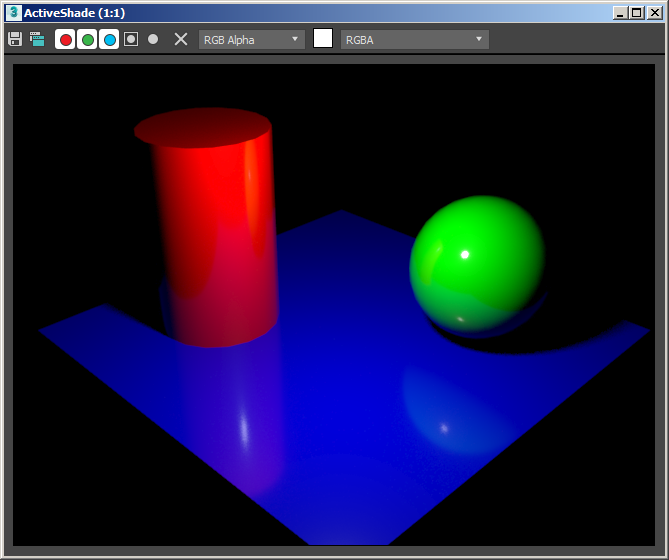

  • Try increasing the specular_roughness of the green standard_surface shader that has been assigned to the sphere.
Increasing the specular_roughness blurs the specular reflection or the sphere
The result of all these changes is available instantly in the Active Shade window so that you can work interactively, changing materials, and lighting without having to re-render to see the effect of your changes. You simply need to wait slightly longer for a better quality render if you have things set up correctly).
