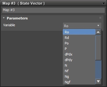

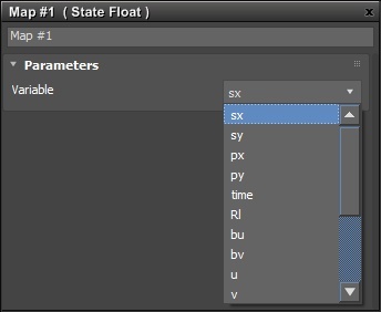

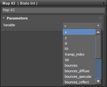

The state shaders allow access to ray and geometric properties such as the surface normal, the UV surface parameters, ray depth, etc. The shaders are separated into float, int, and vector data types.

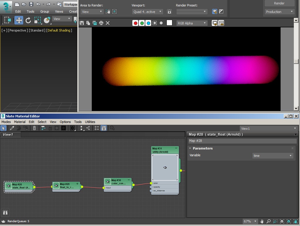

Mapping color to the motion blur using shutter_time
