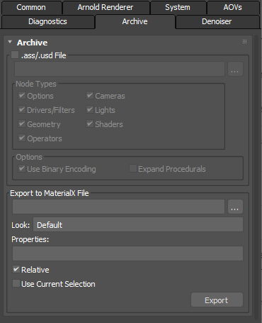

Archive tab with options for creating an Arnold Scene Source (.ass) file (instead of a rendering)
Arnold Scene Source (.ass) is the native scene definition format, stored in human-readable, editable ASCII files.
Exporting To .ASS/.USD
MAXtoA lets you export scenes to .ass and .usd (.usda and .usdc) files that can later be rendered outside of 3ds Max with kick (a multi-platform, command-line utility) or used for rendering via procedurals. It can be found under the Archive tab in the Render Setup. The window will show some Arnold-related options.
Note:
If the options are grayed out, it is because you are in ActiveShade. If you change to Render Production, they should be visible. Alternatively, you can export an .ass file from the File> Export menu.

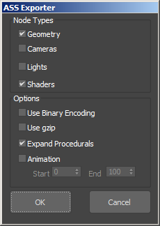

You can also export an Arnold Scene Source file through the normal export options - simply choose the option and define your file name. You'll then get a dialog box with export options:
.ass/.usd File
You can export your model as a procedural via this option. The archive is saved as a .ass/usd file. MAXtoA lets you save scenes to .ass/usd files that can later be rendered outside of 3ds Max with kick (a multi-platform, command-line utility) or used for rendering via procedurals.
Nodes Types
You can also specify which of the following types of nodes are included in the .ass export:
  • Option
  • Cameras
  • Drivers/ Filters
  • Lights
  • Geometry
  • Shaders
  • Operators

Expand Procedurals
A procedural generates Arnold nodes. This option lets you save the generated nodes in the .ass instead of just saving the procedural and its parameters.
Animation
Exports a sequence of .ass files based on the number of frames set in Start/End.
Start
Specifies the start frame of the sequence to be exported.
End
Specifies the end frame of the sequence to be exported.
Relative
If set, the shader/property/visibility assignments will be relative to the namespace the shape is in, otherwise, the assignments will contain the full path to the shape. For instance, if a sphere named 'sphere1' resides in a procedural 'my_proc', the full name would be 'my_proc/sphere1' and the relative name 'sphere1'. This makes it possible to assign the look to another procedural with a different name.
Use Current Selection
Uses the objects currently selected.
