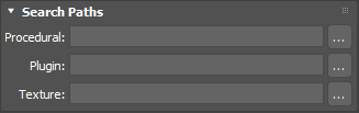

Search Paths
Assets
Defines a location to search for textures and procedurals. LUTs for the tonemap imager also use this new search path.
Plugin Search Path
Defines a location to search for plugins such as shaders, procedural plugins that create new node types, and volume plugins.
For example, if you load ass files from a different plugin, you may need to set the plugin_searchpath to load plugin-specific shaders.
