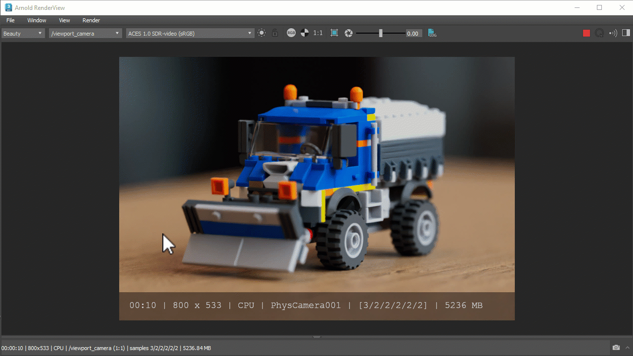

The Arnold RenderView window is an interactive rendering (IPR) utility designed to give real-time feedback on any changes made to the scene while solving several limitations of the DCC's native render view. A long list of artist-friendly features has been added to help with the shading, lighting, and look-dev process, improving interactivity and reducing translation/scene refresh time. For example:
  • Smooth, low-latency render updates take place while dragging the mouse rather than at mouse-release time.
  • Different cameras, AOVs, and shading modes can be selected at any time, without re-exporting the scene.
  • Picking an object with the mouse selects the object in the viewport and highlights it in the RenderView.
  • Isolate objects, lights, materials, and maps for easier debugging of shading trees.
  • Basic color correction.
  • Status bar with comprehensive information about the render in progress and pixel under the cursor.
  • Native 3D camera manipulation, including Frame object selection and Frame all.
  • Keyboard shortcuts for common actions and display modes.
  • Stored image snapshots for easy comparison.

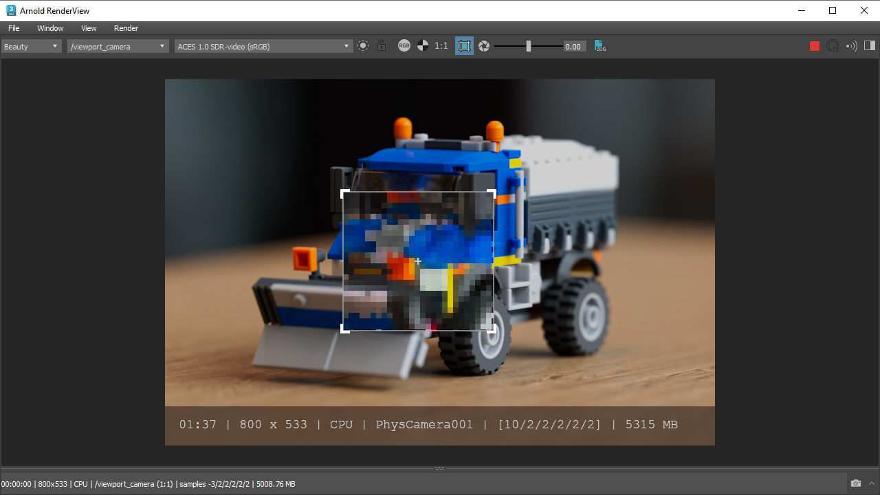

Region Rendering
You can use the Crop Region tool to render it to a specific region only. This can be enabled via the menu Render > Crop Region, by pressing the icon or by keeping the SHIFT key pressed while dragging a region.
Once the region has been selected, the "crop" option is disabled, so that mouse clicks over the image are seen as "picking" (see the section below).
Tip:
To clear the Crop Region and render the whole image, click anywhere on the window while the Crop Region option is active. You can also click on the small cross beside the cropped region to clear the region.

Just below the render buffer, a Status Bar provides information about the render in progress. When a previously stored snapshot is displayed, information about this previous render is displayed.
  • If Debug shading mode is used, the debug mode is shown (OCCLUSION, UV, NORMAL, etc.).
  • If Isolate Selected mode is used, the name of the selected node is shown. A 'lock selection' option is available for isolate selected, which ignores selection changes.
Note:
To display individual materials, maps, or shaders, ensure that no object is selected. Only then will the material/map/shader mode activate. The selection occurs in the SME, allowing one or more materials, maps, or shaders to be displayed simultaneously.
  • " Rendering... " appears when a render is in progress.
  • Render time appears when a render is finished. Note that this render time corresponds to the last AA step, which corresponds approximately to the render time it would take to render this in batch mode.
  • Resolution: width x height.
  • Zoom factor: 50%, 1:1, 200%, etc.
  • Camera name: displays the name of the camera that is being rendered.
  • Device: Displays 'GPU' when rendering with GPU. It won't show anything (by default) when rendering with CPU.
  • Sampling info: AA samples / GI Diffuse Samples / GI Specular Samples / GI Transmission Samples / GI SSS samples / GI Volume Samples.
  • Memory usage displays the memory used for the current render.
When Show Pixel Information is enabled, these additional fields are displayed, relative to the mouse cursor:
  • Pixel XY coordinates corresponding to the mouse position within the rendered image.
  • Pixel RGBA values as returned by Arnold, below the mouse cursor.
  • Luminance values as returned by Arnold, below the mouse cursor.
  • EV exposure values as returned by Arnold, below the mouse cursor.

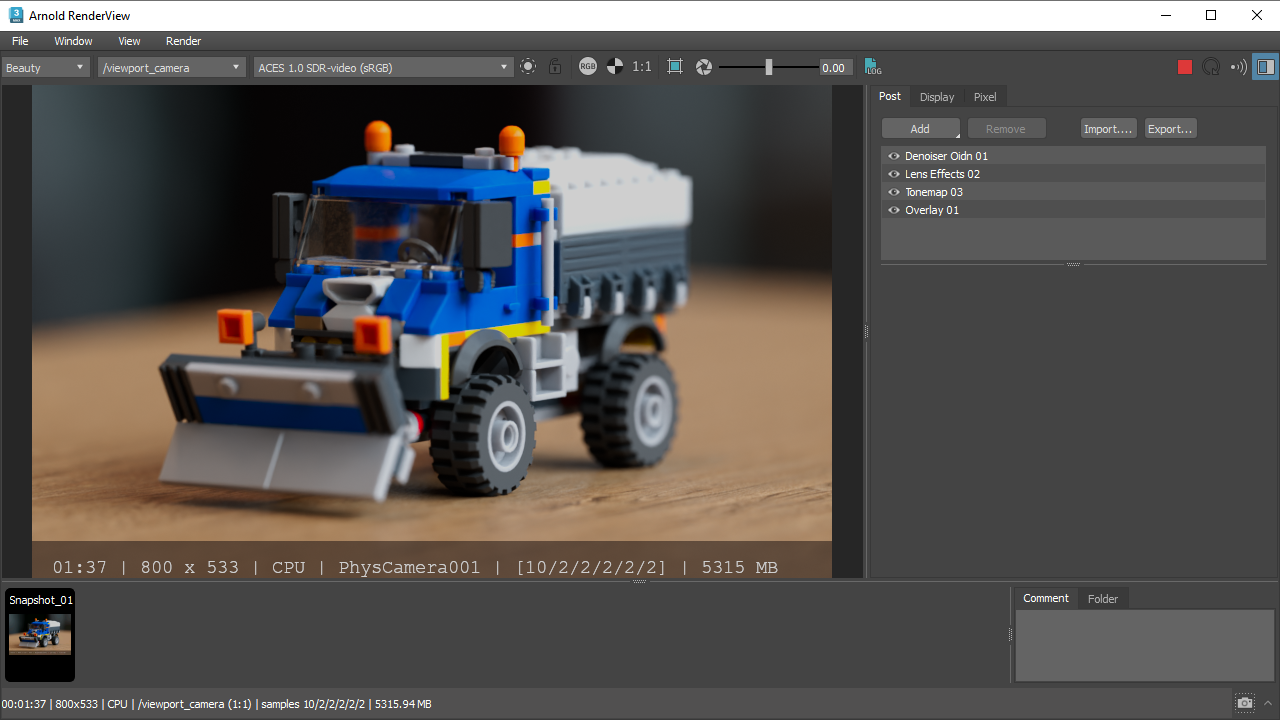

Store Snapshot
Stores the displayed image in memory. When one or more snapshots have been stored, a slider will appear in the toolbar to help navigate between snapshots.
Previous Snapshot
Navigates between previously-stored snapshots. 'Previous' refers to an older snapshot.
Next Snapshot
Navigates between previously-stored snapshots. 'Next' refers to a more recent snapshot.
Delete Snapshot (Del)
Deletes the current snapshot.
Snapshots Folder
The snapshot folder where the snapshots are saved to disk.
Tip:
The left/right arrow keys navigate between snapshots. The up/down keys toggle the display of snapshots and live rendering.
Snapshot library, with thumbnails for each of the stored snapshots. You can also add names and comments.

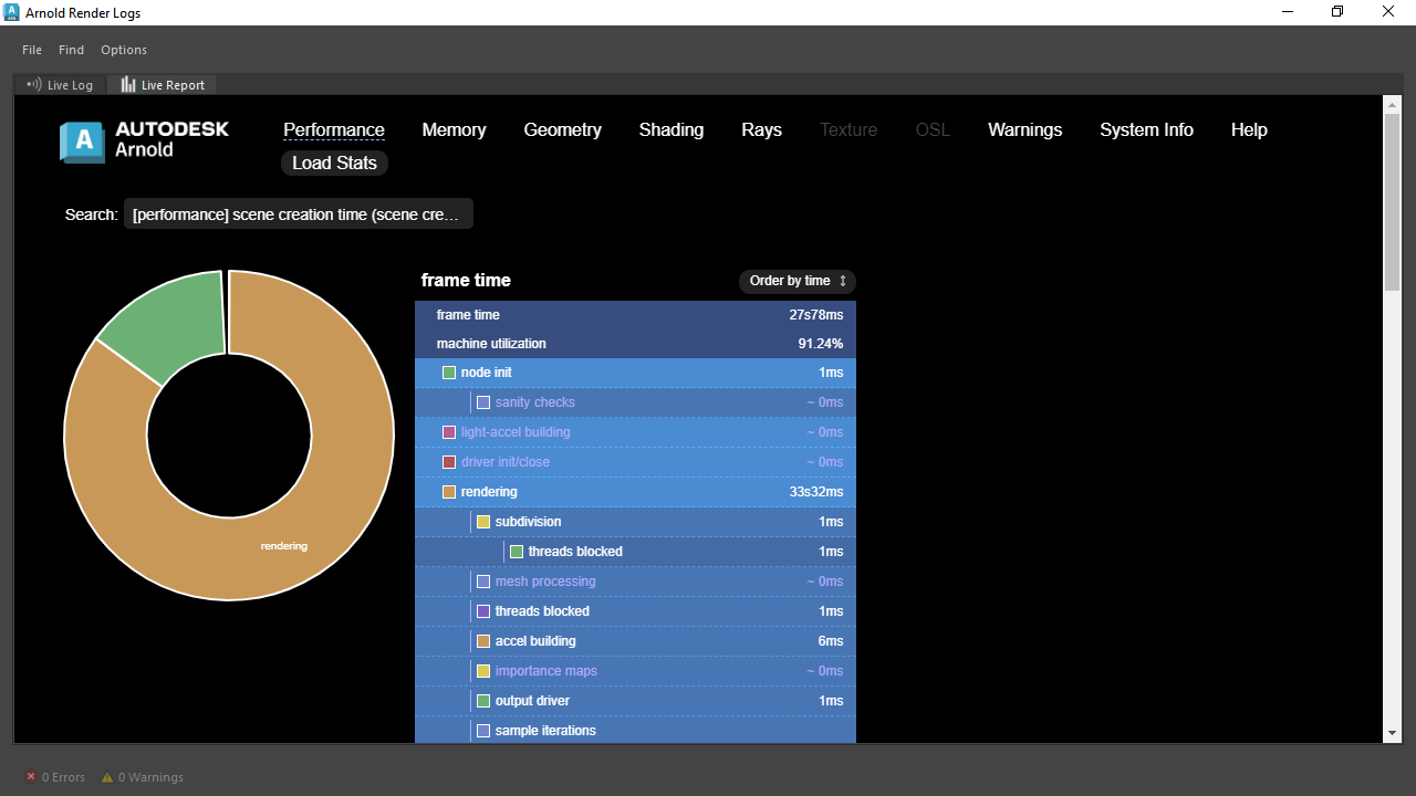

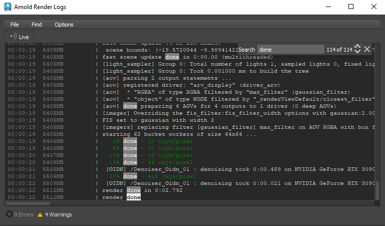

Log
Opens the Arnold Render Logs window where you can view a simple-to-read version of the Arnold log.
Arnold Render Logs window with tabs for viewing saved logs and loading log files
Live Log
Displays a log report of the current rendered scene.
Live Report
Displays an extensive set of tools that allow you to identify performance issues and optimize renders easily. These statistics are also available as an HTML Report.
IPR Log Frequency
Allows you to control the verbosity of the log during IPR sessions. Last Progressive Step means that Info- and Debug-level log messages are displayed for the last progressive step only (Info and Debug messages are not displayed for the AA -3, -2, -1, and 1 steps).
Note:
Information on how to read log files can be found here.

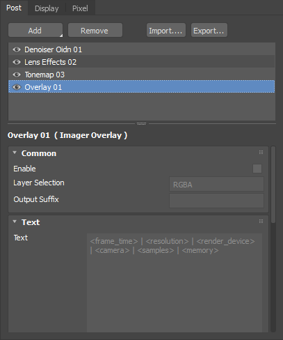

Post
Post-processing nodes called imagers operate on pixels before the output driver. Imagers can be chained together.

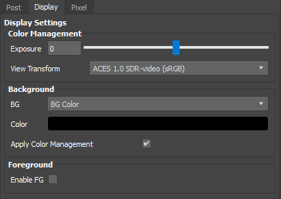

Display Settings
Display Settings
Opens the color correction panel on the right side of the RenderView window, offering various options for adjusting the displayed pixel colors.
  • Exposure: expose the displayed image up or down, in f-stops.
  • View Transform: choose the default color transform to apply for viewing images in the RenderView.
Background
It is sometimes useful to change the color of background pixels in the displayed render.
  • BG Color: applies a flat background color.
  • BG Image: displays a background image or texture.
  • BG Checker: displays a checkerboard pattern as the background.
  • Color: applies a flat background color.
  • Apply Color Management: applies Color Management settings to the Background.

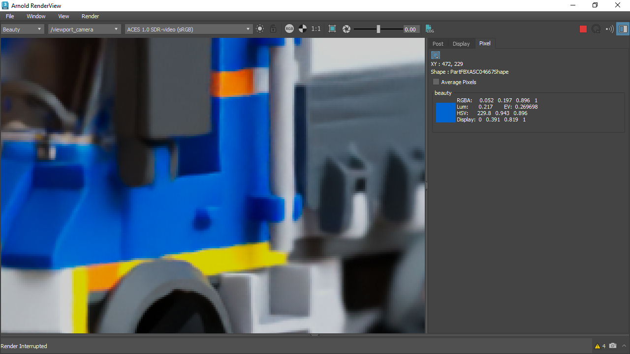

Pixel Information
Shows detailed values for the pixel below the mouse cursor, on all AOVs.
  • Pixel XY: coordinates corresponding to the mouse position within the rendered image.
  • Shape: The name of the shape below the mouse cursor.
  • Average Pixels: The pixel value that is averaged around the surrounding pixels.
  • RGBA values as returned by Arnold, below the mouse cursor.
  • HSV values as returned by Arnold, below the mouse cursor.
  • Display: Color-corrected values below the mouse cursor.

Crop Region
This option allows you to perform a region render by dragging an area in the RenderView. Geometry selection in the RenderView will not work when this option is enabled. Clicking in the RenderView window clears the crop region.
Tip:
You can also drag a region in the RenderView while pressing the SHIFT key to perform a temporary region render.
